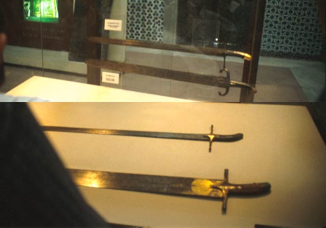

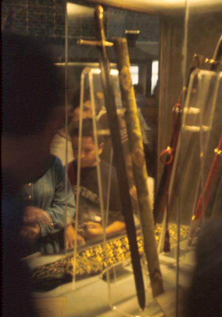

Geoff, you are correct. Middle-eastern weapons during the time of the crusades were similar in appearance to western cruciform swords. They were similar to modern takouba and kaskara.
Here are some shots from the Topkapi's collection:

PostPosted: Wed 24 Nov, 2004 4:18 am    Post subject:         Reply with quote
That's a really interesting hilt. I've never seen a curved hilt like that with that kind of blade. Does anyone know how that affected how they fought with them? Perhaps the curved hilt was a way to keep a good grip on the sword during the cut, kind of like some pommels do. How heavy are the blades in relation to their European counterparts of the period? There certainly isn't much to counterbalance the weight. Unless the blades are light, they must have had a great deal of forward presence. Does anyone here have hands on knowledge of how they handle, or what their style of fighting was like? For that matter, are their any Arabic fencing treatises out there that have survived?

PostPosted: Wed 24 Nov, 2004 8:42 am    Post subject:         Reply with quote
It's actually pretty common all across eastern europe and the mdidle east.
It does two things:
1. Much more leverage into the cut.
2. Slight change of the blade angles on which you move.
The blades themselves, when done up like this, are typically very thin, and hold a very nice edge. Not much counterbalancing to be done. When necessary, the Turks typically used an extra-thick tang to create the blade balance, rather than a pommel. Both are good solutions to the problem -- and if you've never handled a surviving Turkish piece, let me tell you, they usually handle like a dream.
