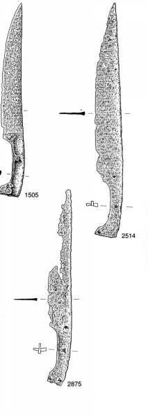

re: metallurgy
Shane is right that these swords (kopis, machiara, falcata) are not widely studied so people don't really appreciate the subtleties.
Sanz is very strict about these differences, and graphs out very tight ratios for the falcata inner to outer curve, as wqell as the distal taper measures and cross sections. Sanz spends a couple pages contrasting the curvature and blade properties of the falcata with the kopis/machiara. He is really failry "tight" about showing the differences...
The of course would affect the handling quite a bit---these falcata are very thin in front, unlike the kopis/machiara. Not the same feel or function, I would posit, given that they are so thin at the tip, and the curve so different, when you really look very carefully. I only wish I did not have to slog through Sanz's Spanish---my 4 years of this language were long ago in high school :)

There is an italian article that shows analysis of a italian sword of this shape. I don´t have it at hand right now. Sorry.
The examined sword is laminated and has a t-back, a wide "fuller" like mid section and a very prominent apple seed edge. Very nice cross section.
The Falcata I got to handle in Solingen weighed some 600 grams (I think. The material is stowed away, but I have posted it before on anohter thread perhaps a year ago).
It was rather short. Total length some 55 cm if I remember correctly. It was *Not* a heavy cleaver. Quite the opposite.
This is a very common mistake you see in print: Wide cutting blades are often described as heavy choppers, just because their outline seems to suggest so.
Falchions, Messers, Falcatas all share this misunderstanding. As a rule these blades are *Not* heavy and cumbersome swords. They are *not* crude choppers. They are light and agile. The cross section is often surpricingly thin in the puter parts toward the point. The edges and cross sections are efective in acheiving weight reduction and sturdy resilience.
The cross section and fuller work on these falcatas is of very high quality and is proof of a very advanced blade smithing tradition.
This is obvious even in severely corroded examples.
The outline and perfect size makes them very graceull. There is a predator quality to these swords, perhaps a stooping bird of pray. I don´t know.
My impression is that the Falcata is good for both thrusting and back edge slashes apart from the obvios cleaving power.
They sit firmly in your hand as the grip is small and very ergonomical. Grasping it feels like a frim handshake. A slight soft pull forwards is the blade asking you to swing away. It is very ready and powerful.The angle of the hilt and the curve of the blade puts the point naturally in line for a thrust, without you needing to extend your wrist too much. You can jab at short distance but also lunge at range or do a curving sweeping thrust below/round a shiled.
...but I am not swordsman. These are just impressions you get when holding one. It was very intuitive and ready in your hand. Beautiful sword!

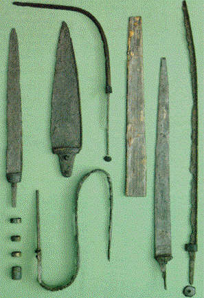

To continue on the Hjortspring seaxes...
a bit off topic, perhaps.
When you read Oakeshott "Archeaology of Weapons" you get the impression the the Hjorspring seaxes look the same as the later Germanic single edged sword or war knife, such as those found in later bog finds.
This is not the case however. The Hjortspring knives (dated around 350 BC) are very different. Much more basic and also quite a bit slimmer. There are three basic types.
This text is quoted from the site for the Hjortspring boat group (http://welcome.to/the.hjortspring.boat):
"The swords can be split up into three groups."
1 "Swords with concave sides, broad back and tang without rivet-holes.
This group includes three of the whole swords and the three fragments of sword-blades. The length of the blades varies from 35 to 57 cm (14 to 22.5 inches); the total length varies from 48.5 to 70 cm (19 to 27.5 inches). The handles are all mounted by applying a bronze knob at the end of the tang. Two of the swords have been deliberately bent before the sacrifice."
(my comment: these swords/knives are like a mix of a straight razor and a bayonette. Narrow with thick backs and dramatic T-shaped cross section. Very specialized swords. Some put forward that these seems to be specialized as thrusting swords against mail. They would be good thrusters on targets without mails as well...No question that they would be wicked slicers.)
2 "Swords with flat sides, somewhat extended back and tang with rivet-holes.
This group includes two of the swords. One sword has a 28 cm (11 inches) long, very broad blade, which is 7 cm (2.75 inches) at the base. It can best be characterized as a stroke-knife. The handle has been mounted with two rivets. The other sword is a little longer (31.5 cm – 12.5 inches) and slimmer (3.5 cm –1.5 inches at the base). The handle was mounted with rivets, fitted with 3 bronze-bands around the handle and a bronze-cap at the end of the handle."
(My comment: These knives/swords are the heaviest in the group. Give an impression of being very effective chopping/cleaving weapons. They do have very cerviceable points as well)
3 "Swords with flat sides, non-extended back and tang without rivet-holes.
A group of slim swords with the length of the blades varying from 36 to 45 cm (14 to 18inches)."
(My comment: this type are much like Sarbatier kitchen knifes, more or less. They may be a little longer and sometimes have a hint of a shallowT-back, and if so not very pronounced. Pointy machetes of medium or small size, if you like)
Here is a pic from the same site:
 Attachment: 27.54 KB
