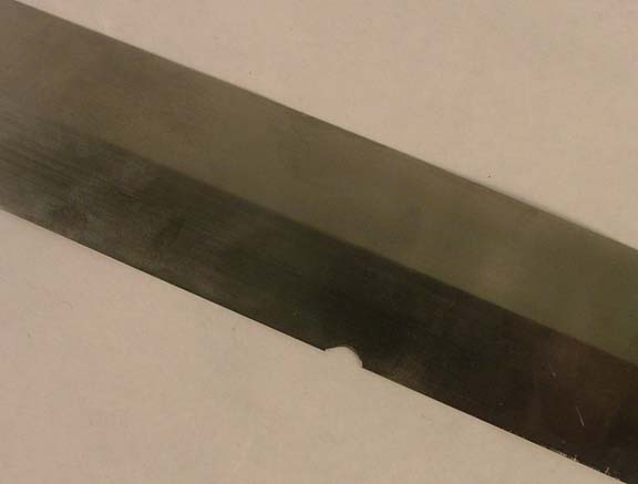

A modifed Albion sword with an "experimental" blade had an edge chip when it cut into an old length of PVC pipe that was supporting a pool noodle.
the sword

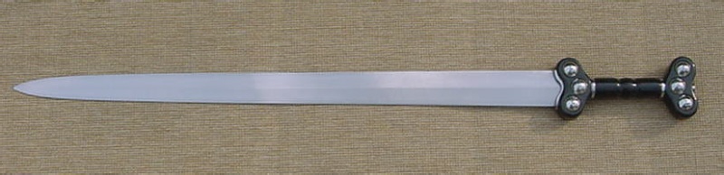

The sword in question was "Problem Child". This sword was a custom hilted La Tene sword that Shane Allee made for me, with a significantly re-ground Albion La Tene blade. As it turns out, this blade was on eof the first blade blanks Albion ran using the new 1075 steel, and using a new heat treating rig. It was one of a batch of "experimental" blades b/c they were still experimenting with the heat treat. This particular blade was quite hard at the edges, very different from the average Albion La Tene blade.

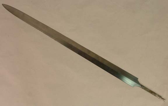

The blank was then reground significantly in profile taper, as can be seen below. Not only that, but the edge geometry was re-ground as well---It had very sharp, thin edge geometry, a veritable razor of a sword. This is historical and appropriate for the sword type we were reproducing. BUT, this did not work well with the "experimental" heat-treat.
The result was that when the blade encountered the old PVC, it resulted in a chip. The chipped blade can be seen below.

This is Problem Child, note the significantly re-ground blade
 Attachment: 25.25 KB
chipped blade--chip is on the side toward the bottom or downward edge, right at the COP
 Attachment: 28.96 KB
chipped blade

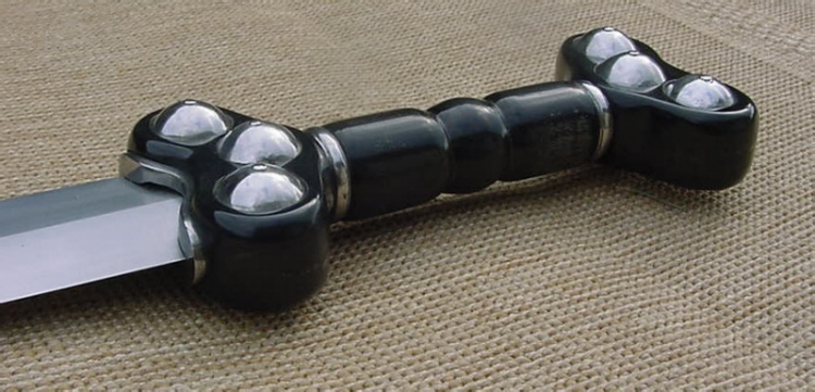

Hey Nate, that "Problem Child" sword hilt looks great. What material is that? Horn or highly polished wood?
Now that I see the photo of the assembled sword I recall seeing other photos of it. That was a very nice looking sword Nate. Thanks for giving us eyewitness facts instead of rumor and innuendo.

Not much I can add at this point. This was the very first sword I finished up, took me long enough too. So it has been very frustrating for me since I haven't had the best of luck with projects this year. Then I start hearing from Nate and Albion about all of these rumors that are floating around about it. The rumors...yeah that makes me mad. What really makes it even worse for me is the fact that I put so much into it. I based this on an original hilt, there was twenty five individual hilt pieces, hundreds of design modifications to get it as close to the original as I could. I know there isn't that many people interested in the La Tene period, but still...it didn't mean jack to anyone outside of a few until they could turn it into a wild rumor about an Albion blade breaking. Wow, that certainly made me feel great.
At this point though I really don't care. My drive isn't to make swords for other people, it is to learn how to do it.
End of my rant.
The hilt is buffalo horn and the fittings are wrought iron. Here is a close up of the hilt.
Shane
P.S.
This isn't the end for it though. I saved the guards and wrought fitings, getting a couple more Albion blades, and I'll take another shot at it. Then a La tene for me.
 Attachment: 106.91 KB

Shane is going to give this another go, and Albion is already goong to supply a blade blank with regular heat treat for the project.
The big shame of this is like Shane said---bad press detracted from a marvelous sword. Not only did this cast a bad light on Albion generally, but on Shane's work of art.
The completed sword had absolutely beautiful balance, and it was light, light, light. The Albion version is already sub 2 lbs, and this one, whether through weight or balance, felt like a willow switch in the hand.
It had a wonderful, graceful profile taper that so typifies many of the "solid middle" La Tene II's. This is something of the profile shape I have talking about a lot lately, that is not represented at all in the replica market, and I believe Shane (with some help from Rick) really nailed the type-shape.
In cutting, it was a dream on light targets (the light targets were appropriate given the experimental heat treat, as Problem Child had absolutely no trouble dicing pool noodles into onion rings, only PVC gave it trouble)
I know it's over-used but this thing went through pool noodles with no feeling of resistance, and the balance and weight of this piece were such that one could make quick and immediate return cuts, one after the other, in very rapid succession. One really could make go "snicker-snack" with a blade like this (yes, even I was able to do that with this sword)

Regarding the chipped blade, why can't you just sharpen around that area? Would that weaken the blade too much? As a comparison, nicked and chipped scythe blades are just repeatedly peened and sharpened until - over time - they can have quite a wavy edge. A scythe is a slicing tool that is unlikely to encounter the torques and stresses of a sword blade, but it still seems there is enough steel left in the sword to hold up to most use......
