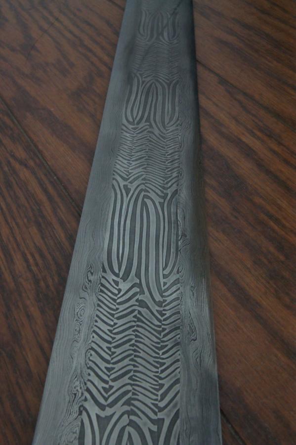

Vince has just made a new blade for me. We went to see the original in the British Museum together and had a really good look at it - they were kind enough to take it out of the case for us. Vince had already discussed the blade with Janet Lang of the BM and carefully considered the x-rays. This is the result.
You may notice that it doesn't have a fuller -- well that's because there is no evidence that the original did either, in fact, quite the reverse.
The hilt will be made by Dave Roper.
All the pictures were taken by Vince.
Paul

excuse me while i move my keyboard so i avoid drooling over it... those pattern weldings NEVER cease to amaze me.
the tip seems alittle blunt though. is that on purpose or hasnt it gotten through to sharpening yet?

My Limited understanding of the tips of migration period swords is that the tips were blunt, so when used from horse back they did not get caught up in the bodies of those that had been skewered.
My understanding is that these swords were biased on the roman cavalry swords, which were in turn biased on Germanic swords.
That sir is a very nice sword, and I am most jealous.

Thank you for your kind comments. This was probably one of the most interesting projects that I have done – everything from the researching and examining of the original blade and radiograph to visiting the Sutton Hoo burial site with Paul to forging the blade. The craftsmen that made the original sword were very talented and we have much to learn from them.
The blade without a fuller will feel very different. It is broad with very little taper to the profile.

Very attractive blade and I really like the very rounded radius from blade shoulders to tang from a design and structural strength point of view: I wish that many custom makers or production swords used such a transition when the design and style of sword permits.
Really love the pattern welding and also looking forward to seeing the finished sword. Big Grin Cool

I do have a question, probably for Vince, as he forged the blade - what steel was used to create the welded-on edges? And what is the resulting characteristics of the sword after the heat-treatment? It is very intriguing to learn that this sword had no fuller - would be really fascinating to have the handling characteristics explained to us by Paul once he gets everything finished...

When Paul asked me if I would be willing to make a blade for him, our goal was not to replicate the metallurgy of the original, but the intent of the smith who forged it. We chose to use modern alloys that would show the pattern well and provide the strength and edge holding that should be expected of a sword. The steels that I used are 1095 (a high carbon steel) and A203 (a nickel bearing mild steel). The ratio for the core bars is 1:1. For the edge bar I used thicker 1095 layers and welded it to a total of 512 layers to achieve a fine grain pattern. The edge bar is harder than the core bar which has a much springier nature. This gives a very tough blade.

As Vince says we didn't attempt to use the same materials that were in the original, but that would be difficult anyway, as no serious analysis of the metallurgy of the blade has ever been carried out - at least not one that I am aware of.
Now that I have the blade in my hands, I must compliment Vince again on the sheer beauty and presence of the blade, it is a lovely piece and I must thank him for the thought, effort, talent and expertise that he put into this project. Vince really studied the original and all the documentation that we could find available and discussed the blade with Janet Lang at the British Museum.
