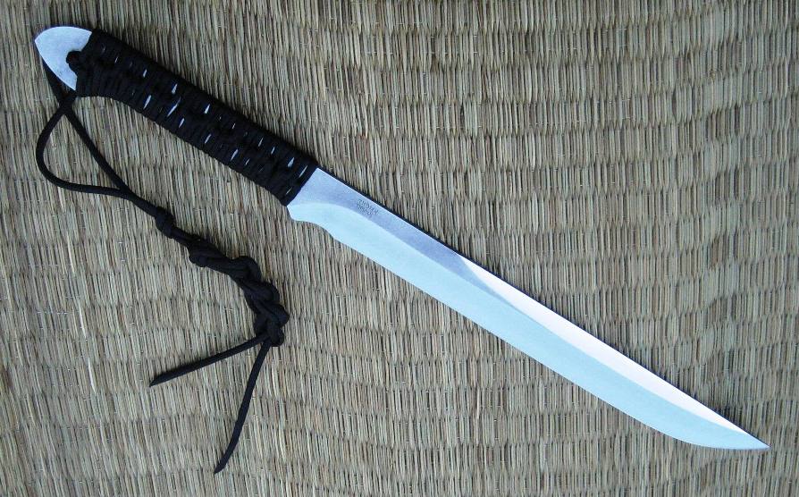

Hello, everyone. This is my first post so please excuse me if I am posting in the wrong forum.
From what I've read on your forums and other forums, this Angel Sword company seems to be loathed or loved by all. So, I would please ask that we refrain from starting a debate about their products. Thank you. I should also mention that I know nothing about weapons, melee-active history, or steel. I apologize if I seem too newbish.
Any way, I have been looking at this weapon from their website and it seems to be the one that I've always been searching for. It's not really a historical weapon at all but it is the ideal design that I've always wanted. The problem is... it's $1,000 USD. I can't really fathom how a piece of 1.25' steel with 3/16" thickness and a wrapped handle would run that much but I assume it has to do something with this patented "Advanced-Thermal processing" and S7 Shock Resistant steel.
So, my question to you all is (and this may be a shot in the dark): have any of you ever seen a similar design to this weapon? I do like the wrapped handle but mainly it is just the shape of the blade. Nice and straight with a rounded edge and then the handle is dripped down.
I'm aware that is a pretty vague specification but if anyone knows where I could get a weapon like that for a price that wouldn't put me out on the street, I would be much obliged. I'll attach the image of the weapon in question, as well.
Thank you all again so much.
ETA: The link to the weapon: http://www.angelswordstore.com/index.php?page...;Itemid=92

Take your time before deciding on what to buy and be skeptical about advertising buzz words like " battle ready " for example that is almost meaningless for example except that it " might " differentiate from a wall hanger with a fragile handle assembly ( Rat tail tang ) that might break at the guard if one waves the sword in the air a little too fast.
Same thing about secret patented magic steel and secret heat treat processes. ( Buyer beware. Wink )
If you are buying an Albion sword or A&A sword or any other high end production sword you should expect to pay at least in the $800 to $2000 range in price depending on the model of sword.
There are also much less expensive swords make of quality materials and good design, for some of their swords offerings, by other companies that can range from $300 to $600 more or less. ( Hanwey or Windlass for example ).
There are also, way over priced swords and designs not any better than a $300 sword but priced like a high end product.
If it looks like a sharpened crowbar, has no subtleties of profile or distal taper and handles like a sharpened crowbar it might not justify a premium price.
So spend a little time here looking at reviews, check out the different production makers and custom makers to see what the quality stuff looks like and at what prices and then decide if a specific sword seems to meet the same quality/price criteria.
Reading a bit about steels and heat treats ( Feature articles here on " myArmoury " or google it ) should help in being able to tell the difference between accurate specifications versus advertising hype.
Well, to answer your specific question about " where " to find you could search on this site that has just about everything from low end to high end swords and is a very good and reliable vendor who has a great reputation for great customer service: http://www.kultofathena.com/
You can even e-mail Ryan Whittlinger, the owner, if you need honest advice about what product at what price range you are looking for.
This one at half the price: http://www.kultofathena.com/product.asp?item=...al+Yatagan
Or look at this, scroll down to middle and there is something similar to what you want:
http://imakeswords.com/tactical.htm
Home page of above: http://imakeswords.com/products.htm
Good quality steel and heat treat by the way.

Actually, the main reason I was interested in the blade is because the claim of "500% more durability" enticed me. I'm very interested in find a blade that is actually "battle ready" as you put. Of course, the weapon I am looking at isn't a sword at all so I'd be less worried about it breaking. I have bought cheap blades in the past (swords included) that always broke over something silly.
I'm sure this is a daft question but.. do manufactures even produce swords with "battle" in mind any more? It seems to be more-or-less about showcasing but I'm actually looking for a weapon that can take and deal abuse.

Depends on what you mean by "battle ready". Modern swords using modern alloy steals and controlled heat treats are MUCH tougher than historical swords. So real swords from people whos lives actually depended on them were significantly less tough than many of the offerings available today.
Often times modern makers overbuild their swords. A period sword would never be expected to hack into a cinder block undamaged or flex to 90 degrees repeatedly. Yet many modern sword buyers expect such things.
It sounds like you want a sword to take abuse. Just understand that real historical swords, swords that actually went through battles, were not designed to take such abuse...

Glad to help, and even Kult of Athena uses the " Battle Ready " term because too many people expect to see it and think it means something: The Battle Ready is often in the makers' description and it gets repeated on the vendors site.
If by " Battle ready " you mean sound construction from good materials that would function in period for a historical sword like a sword should , then yes there are good swords out there if your expectations are realistic.
Keep in mind that even the best steel sword with take nicks and damage to the edge when used against another sword and swords are not meant to chop down trees etc ..... The 500% better than anyone else's steel is unrealistic because if such a miracle steel existed, every premium knife or sword maker would be using it, at least for modern sword interpretations.
No such thing as swords cutting concrete pillars in half and showing no damage. Wink Big Grin Cool
What a real sword is expected to survive is normal sword use and extremes of abuse will destroy or damage even the best custom sword.
Some short very heavy blades might survive hitting something like a large tree trunk or a steel structural beam but edges to cut have to be thin, so even if the rest of the sword is way overbuilt the edges will still nick, chip, roll if abused.
Unfortunately no " Light Sabres " or indestructible swords out there made of " UNOBTANIUM ".
But on the other end of the quality spectrum one can find swords or blades that are seriously inferior and will damage more easily than the high end ones.
"500% more wear resistance" isn't "500% more durability" in what matters for swords. Very high wear resistance isn't even necessarily a good thing in a sword: harder to sharpen.
"Double the toughness" matters more. That's double compared to "good" conventional heat treatment of S7.
S7 looks like it might be a good sword steel. 0.5-0.55% carbon, high impact resistance (perhaps about 10% higher than 9260, for "good" conventional heat treatment of both the S7 and 9260). So, the claim is, approximately, "double the durability" of conventional "tough" swords.

What's your application for this weapon, Dylan? That's the essential piece of information. Really, not much else matters. If your life is on the line, price should be no obstacle. HOWEVER, those whose lives are truly in danger probably aren't worried about what knife they're carrying, much less paying $1000 for it. They're too busy tending their government-issued SCAR, M4, HK, etc. In fact, somewhere in these fora is an (apparently) informed observation that some SF guys really do get good kitchen knives and duct-tape the grips.
FWIW, when I wanted a new general-purpose sheath knife I got one of these to modify by shortening the blade from the tang end:
http://www.amazon.com/Old-Hickory-10-Butcher-Knife/dp/B000KKIT8U

"I can't really fathom how a piece of 1.25' steel with 3/16" thickness and a wrapped handle would run that much..."
Pretty much said it right there.

I noticed that the overall length of the S7 is actually 17 inches which would qualify it as a dagger. There are many custom makers who could make something of that size with similar characteristics for much less money. I might look into OlliN. They are quite good and have made similar looking weapons in the past. In fact, they have a weapon with a similar blade but different grip for sale right now for less than half of what the S7 costs.There is a link to OlliN on the links page of this site.

Dylan Hopper
Location: United States
Joined: 09 Aug 2012
Posts: 7
PostPosted: Fri 10 Aug, 2012 9:08 pm    Post subject:         Reply with quote
Thanks for the responses. The metal coding makes sense now. As for equipment, I'm well prepared and have done this before. Just need a good knife is all.
I'm still scouring through all the links I have been given so I'll update with my decision hopefully soon.
Thanks!

PostPosted: Sat 11 Aug, 2012 2:17 pm    Post subject:         Reply with quote
JE Sarge wrote:
I really like the Zombie Tools stuff for tactical applications. I don't care for the funky post-apocalyptic paint jobs, but the blades themselves are pretty damn nice. They have good balance, durability, and excellent cutting/thrusting properties. Their price will not break the bank, and for the price, you could have a 2-3 of the same model - which is the letter of the rules of redundancy in bad situations: having 1 = none, having 2 = 1.
As for Angel Sword, I have held many of their swords over the years, but none of them have really impressed me with their balance, handling, or aesthetics. Sure, they might be made out of some type of secret super alloy, but as for me, I don't like their designs enough to invest in one. They just don't feel right in the hand.
Hey, JE Sarge. I must have missed you reply earlier before replying to everyone's.
After Lee O'Hagan linked me to the Zombie Tools website, I must say I am rather addicted to their first three models present. The Apokotana, Zakasushi, and Tainto are amazing looking, to me. Of course, I'd never need a sword but I was impressed by watching the clip of the guy swing the full sword through 24 cans of beer.
In fact, this Tainto, while looking not much like my previous interests from Angel Sword, may be the way I go. It's a fraction of the price of the AS and looks pretty great. I believe they use 5160 steel quenched in oil. Also, it's full tang which is great but I'm still a little worried as to how well the handle would hold up. I have lost all trust for knife, dagger, and sword handles because I've never really bought a good quality knife and they always seem to either break at the handle or folders become extremely floppy at the fold.
It sounds like you've personally used a Zombie Tools weapon. How quality did the handle feel?
