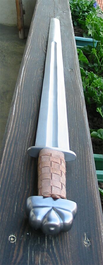

I just uploaded four high-res photos of Steve Maly's new Riccard viking sword from ArmArt. Steve sent me the photos and I added them to the photo album database.
From all accounts, it sure looks like a very nice sword.
What do you think of it?

PostPosted: Sun 21 Sep, 2003 3:09 pm    Post subject:         Reply with quote
Much more to my taste than the ones on the Armart website. Looks very well done. Any other specs. available?

PostPosted: Sun 21 Sep, 2003 4:54 pm    Post subject:         Reply with quote
Nice hilt, ugly point. Looks better than most other ArmArt Vikings. Peter J handled an ArmArt "Sword of Prayer" a while back. He wasn't impressed by it.

PostPosted: Sun 21 Sep, 2003 4:56 pm    Post subject:         Reply with quote
I think it's very nice, and I'm glad to see someone getting satisfaction from ArmArt.
I don't care for how the grip was done, and I'd prefer to see just a hint more taper towards the point. That's all just personal preference though. All in all it looks like a quality piece.

PostPosted: Sun 21 Sep, 2003 7:05 pm    Post subject:         Reply with quote
Here's the Specifications from the ArmArt website:
Total length : 95 cm (37.5")
Blade length : 79 cm (31")
Blade width at guard : 50 mm (2")
Blade thickness at guard : 6 mm (0.25")
Fuller length : 76.5 cm (30.25")
Fuller width at length : 20 mm (0.75")
Grip length : 10 cm (4")
Balance point : 15 cm (6")
Weight : 1.33 kg (2.93 lbs.)
Bjorn & Patrick: I usually prefer a less spatulate tip on my swords as well (probably why I don't have a Katzbalger), but the overall presentation of the sword overcame my prejudice. The tightly wound leather cord grip is surprisingly soft and comfortable. Overall, I give it a "thumbs up"--pretty good choice for my first Viking sword.

PostPosted: Mon 22 Sep, 2003 6:56 am    Post subject:         Reply with quote
It is a very good looking sword. But for $1000+ they should have been able to make the etching on the pommel straight.

PostPosted: Mon 22 Sep, 2003 7:54 am    Post subject:         Reply with quote
Thank you Roger...I didn't want to be the first.
I noticed this sword on ArmArt's website a week or so back and was bothered by this. The sword is major step back in the right direct for them, and someone put some major time and effort into this one. Attention to detail is what I look for in more expensive work, it looks like they did a pretty decent job at this till the engraving process. I'm anal about these kind of things, but it would have looked better to me if it had just been left off.
