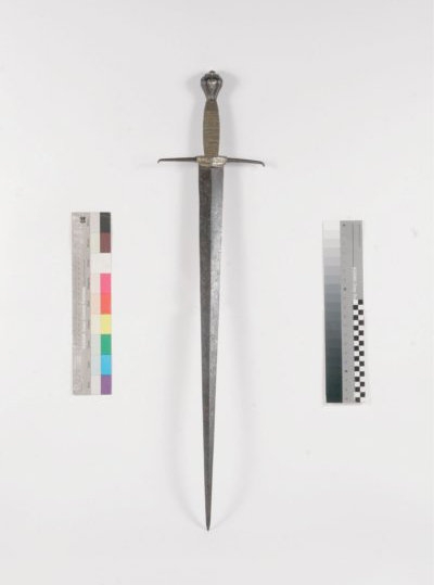

I am looking for examples of scent-stopper pommels on single-hand swords ( or borderline hand-and-a-halfs with relatively short grips.) Any help would be appreciated. I have a blade and cross-guard that I would like to put a scent-stopper on, but I cut the tang shorter than I should have, and as the vast majority of scent-stoppers I have seen have been on long-gripped swords I would really like to see a short-grip with a scent-stopper to give some historical plausibility to the project before I finish it. If I can not find any, I will have to fall back on a sherical pommel.
You could always create some tang out of the top of the blade.
What particular pommel form do you have in mind, and for what period?

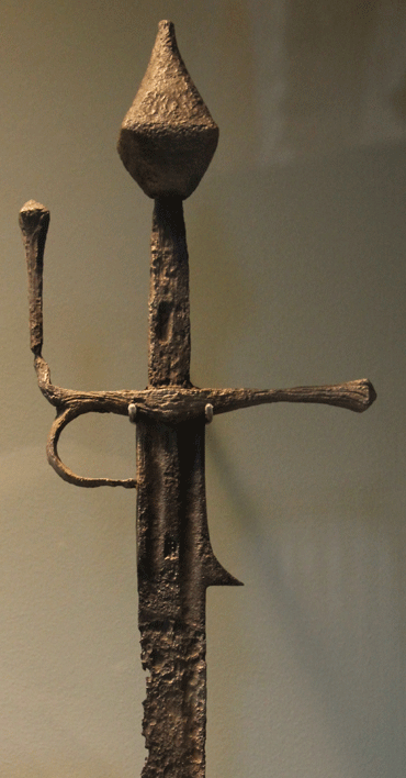

The blade is only about 70cm long, so already at the minimum for my own preferences. I am now considering welding a tang extension on. If I do go with the single-hander, I want to do something similar to Museumsnummer T5273 at the Vitensmuseet Norway (http://www.unimus.no/foto/#/I=46334VM) This sword has a fairly short, tapered blade with a long, broad fuller, a wide curved guard with back-curled ends and a spherical pommel. Basically it is like one of the main types of long-gripped Scandinavian longsword but with a short grip. Some of the long-gripped version with similar guard have scent-stopper pommels of the flat-faceted type as opposed to those such as one sees on Albion's Dane. I would prefer to do the scent-stopper over the spherical because the spherical would have to be much more hollow to have both the appropriate volume and mass. If I do manage to weld on a reasonably strong tang extension, then of course my pommel would have to be much lighter still. The blade as it is only weighs 600g and has pretty strong distal and profile taper, so either way it will need a fairly light pommel in comparison to other swords of similar grip length. I hope that was coherent enough, I just got in from the New Mexico heat and my brain is probably running at about 102 degrees ;)

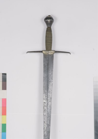

I'm actually seeing more single hand swords with approximately with roughly this type of pommel than with the mandarin type. The period you're looking for is ~1400-1450, and not just Scandinavia. The faceted scentstopper pommels seem to be very popular in the German-speaking lands, but more typically in hand-and-a-half form.
 Attachment: 154.59 KB
 Attachment: 146.62 KB
 Attachment: 197.08 KB
 Attachment: 185.07 KB
All first half of the 15th. c.:

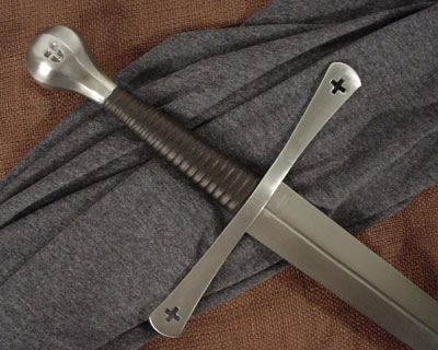

Here is a photo of a sword from around 1400 or maybe a little earlier. Del Tin used it as a model for their DT5144
 Attachment: 10.47 KB
 Attachment: 31.52 KB
DT5144
