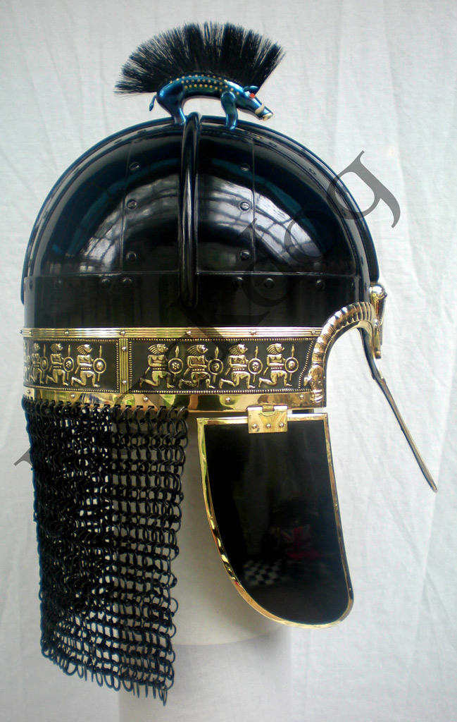

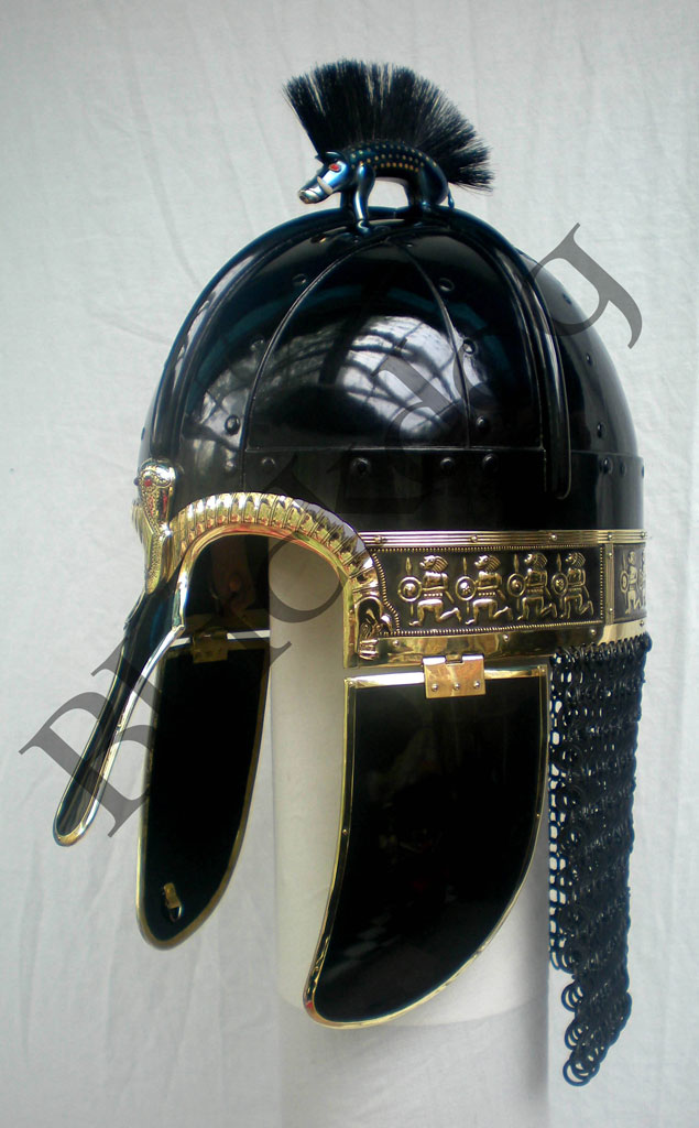

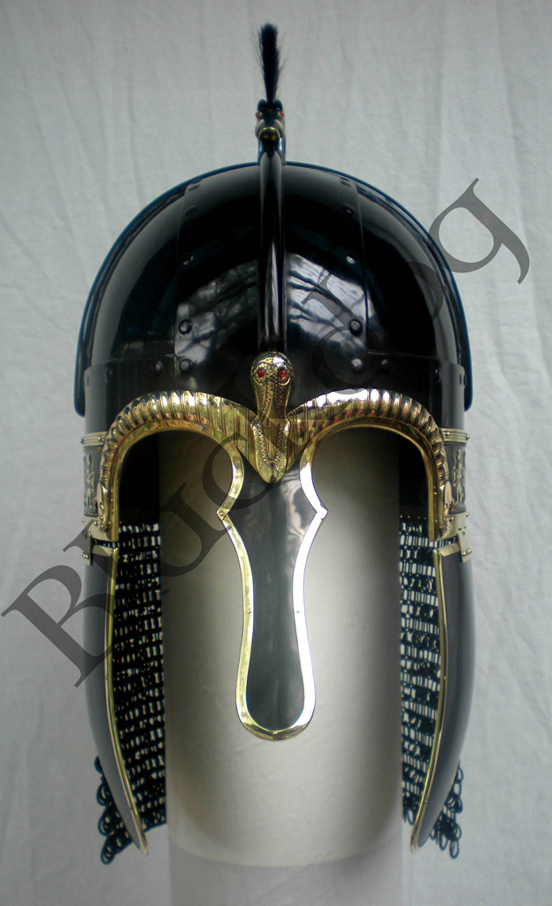

Hi Guys,
here is my latest piece, a conjectural helm for a myArmoury forumite. It is an amalgam of components from various Anglian pieces, with the intention of creating a feasible helm of the type that could have been decorated with the press blech foils found in the Staffordshire hoard. Also the client expressed a keen desire to create a helm that borrowed its structural feel from the Coppergate helm, but wanted to be more in keeping with the earlier pagan Anglian helms like the Wollaston helm.
So essentially, the construction of the bowl of the helm and the cheek plates are taken from the drawings in the Dominic Tweddle book on the Coppergate helm. However, the drawings are not technical blueprints, so some adjustments had to be made to maintain symmetry and to conform to the clients head size requirements. The helm itself is made from 2mm thick steel which was cold forged to shape. The spangen plates, cheek plates and brow and ridge bands were all planished to a fine degree then polished smooth by hand.
Lateral and Longtitudinal bars were also fitted which are borrowed from the Wollaston Helm. these were shaped and rivetted to the helm with hidden rivets.
The decorative elements of the helm were from several same period pieces. Firstly whilst the eyebrows appear to be the coppergate ones, the terminals at the ends were substituted with the wild boar ones from the Sutton Hoo helm eyebrows.
However the shape and finish of the eyebrows are essentially the same as those on the Coppergate.

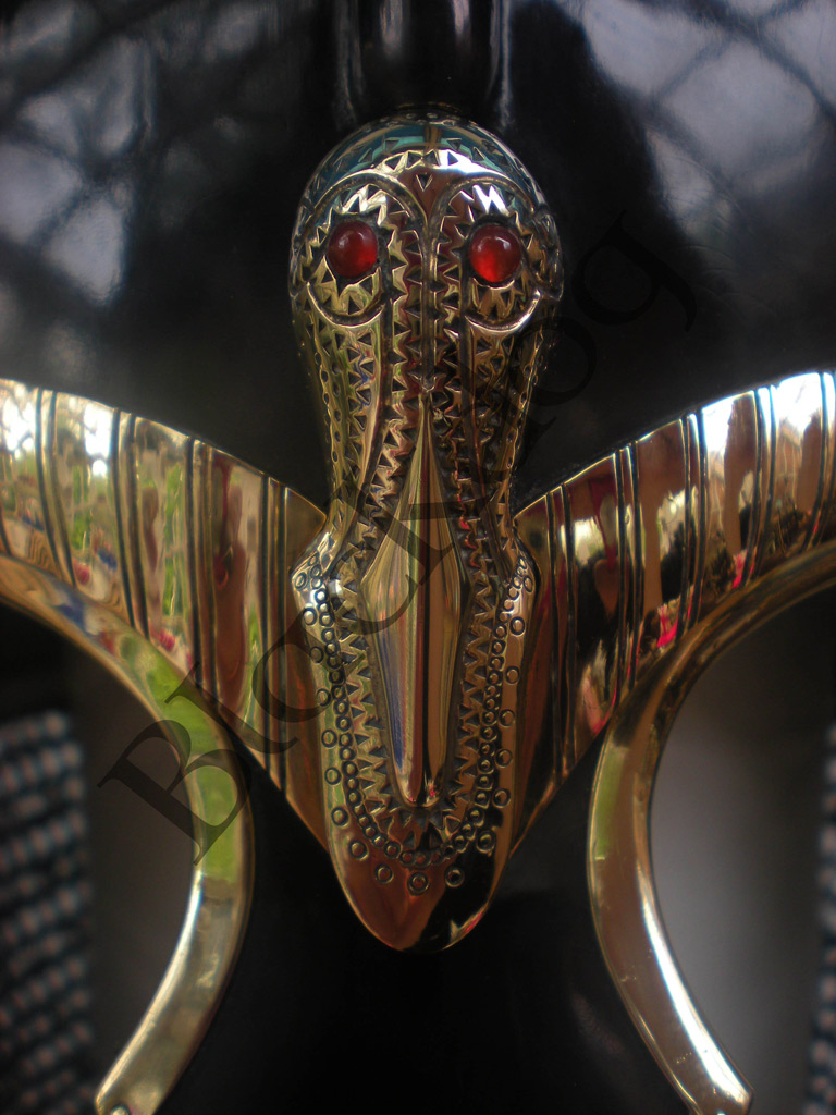

The Ridge terminal on the coppergate was not stylistically suited to this particular project, so the client chose a piece typical of crest terminals of the period, ie, Spatulate, Zoomorphic, with, in this case cabochon eyes. As the client did not want to take one directly from, for example a Vendel type helm, a perfect piece was to be found on the grip decoration on the reverse of the Sutton Hoo shield.
Both the eyebrows and the crest terminal were not cast, but were actually carved 'in the metal'. The decoration on the crest terminal was also hand stamped.

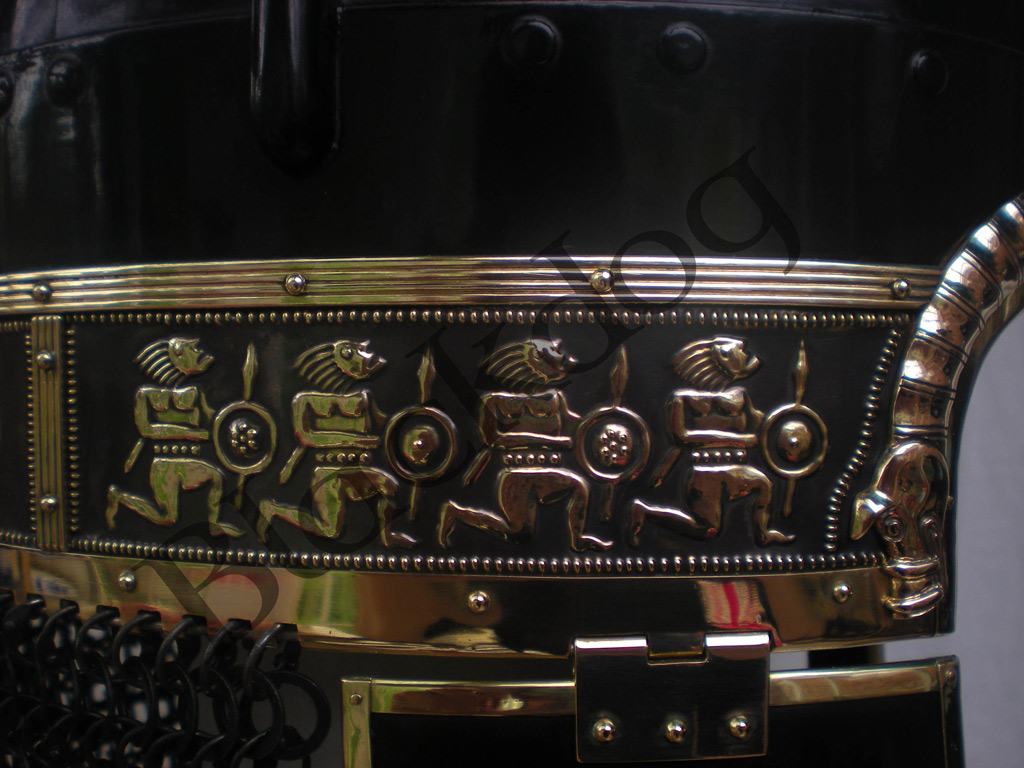

For the press blech foils adorning the brow band, the 'processing warriors' motif from the Staffordshire hoard was chosen, The dies for which, were also hand carved not cast. Also, conforming to the clients request, 'mirror' image press blech foils were made so the warriors on each side of the helm processed towards the front of the helm.
The press blech motifs are not to scale with the originals, however it was decided by the client intentionally that this was acceptable and echoed the sentiment of the originals.

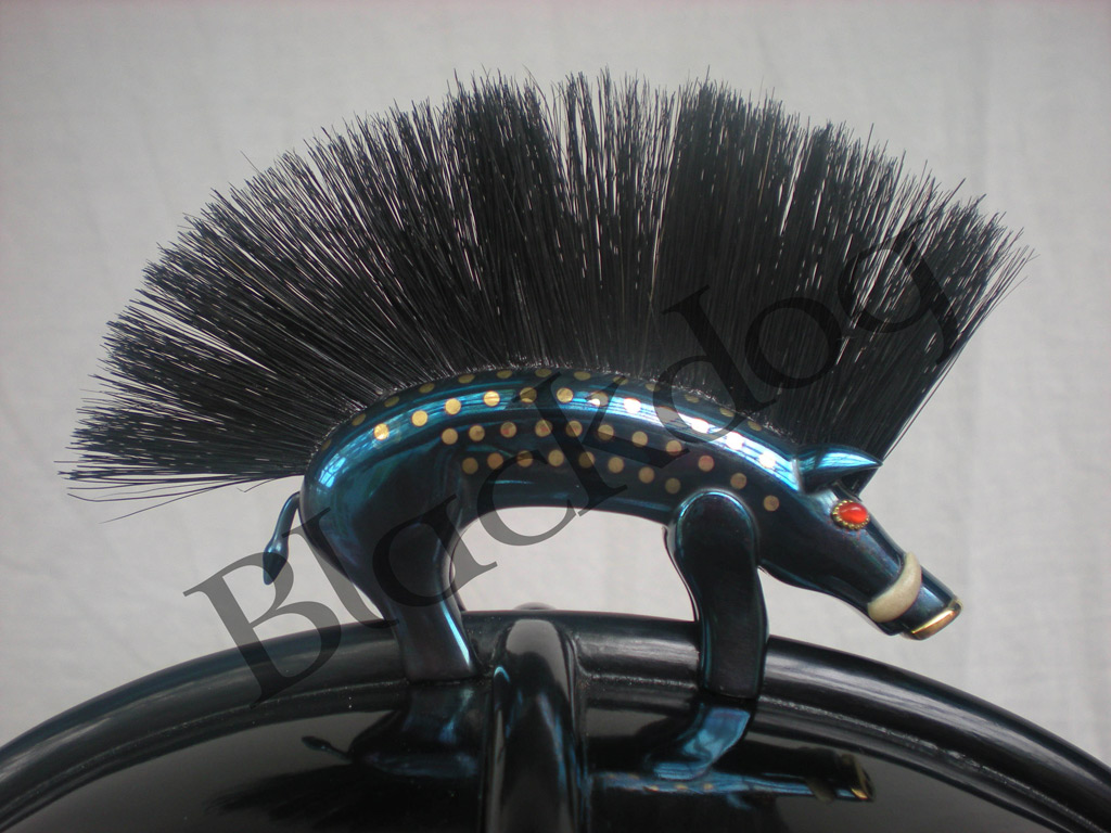

Finally, to top the helm off, and continuing the wild boar theme, it was decided to borrow the Boar crest from the Benty Grange helm to complete the Overall look of the helm. Also to put it squarely in the context of the Wollaston helm, but to be of a higher status to some degree.
The Boar itself is not identical to the Benty Grange but is stylistically influenced by it for the most part. The main differences being the lack of Gold haunches on this version. the 'gold' dots around the sides of the boar are inlaid brass rod (to keep the cost down), I used boar bristles to do the crest along its back. The tusks are Deer antler and the Eyes are Cabochons set in filigree surrounds. The Boar has been heat blued to set it apart from the helm and sits astride the brow ridge. The Boar, was again, carved in one piece from a solid billet of steel and polished to a high finish
A spider type leather suspension has been fitted internally and a black maille aventail was fitted which is alternately rivetted and solid links.
I hope you like it. it is my second ever helm and this was the first time I have attempted to do Press Blech.
I have hear feed back from the client, who I can name as Dave Huggins, he is very happy with the result, and it seems I have exceeded his expectations which is all one can ask for. Dave will be posting pics himself on the Vendel Madness thread later. My own Thanks to Dave for his help and inspiration and to fellow forumite and Daves Colleague Bruce who also provided insight and acted as Daves Liaison in his absence.
