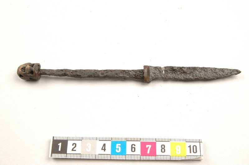

I was playing around with CATIA practicing making advanced surface modeling and got the idea to make a model of this viking age knife find from Mora (in northern Sweden).
Yes, a real Mora knife from viking age. This is one of those knives with a thick back cross section and round handle and I rarely ever see them reconstructed.
http://www.kringla.nu/kringla/objekt?text=vik...ect/839539
http://mis.historiska.se/mis/sok/bild.asp?uid=331660&g=1
This is the result where you can see what it might have looked like when it was new and I think it looks really sweet.
The dimensions are a bit off, probably the blade should be shorter and have a little less of a drop point, but you get the idea.

Are you certain the handle was round in cross-section? I ask because round handles on an edged item are not comfortable to use, and most of the knife handles of the period I have seen cross-sections for are usually oval or tear-drop shaped, as are the vast majority of modern knives of nordic origin...
No wood left on this one so we can't know anything for sure really, though if the handle was oval or teardrop shaped as we see a lot then the fittings would most likely be too like they are there.
I'm calling it a decent elementary guess, best anyone can do really, and if anyone feels like making one where the wood bulges out or is cut in at the middle that works for me too.
Of course this particular knife could have had any sort of handle in between the end fittings, ribbing, bulges, grooves and so on, but both the front and back fittings are round which gives a good indication the organic material handle would have followed the same lines, especially if my theory about it being primarily used for food or fine crafts.
There are several finds of what the archaeologists dub viking eating knives with more plain round cross section handles intact. Two separate finds are listed and photos presented in the "From Viking to Crusader" book and I've seen at least one IRL at a museum.
Yes, they seem impractical for use to splint and whittle wood, or rend meat like it's much bigger cousins. But these are tiny knives anyway not fit for heavy work. I see cutlery as well as surgical and precision point crafts work possibilities and maybe for that type of use a round handle is better after all.
