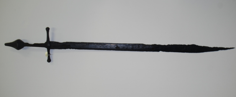

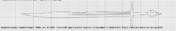

PostPosted: Sat 19 May, 2012 9:55 am    Post subject:         Reply with quote
Royal Armouries IX.5409
Some say it is from Castillon Group C (?) Others say, because it is a falchion, it can't be included. It certainly has a Castillon style hilt.
OL - 37.17"
BL - 30.32"
BW at guard - 1.26"
Grip length - 3.54"
Weight - 1.9 lbs
 Attachment: 42.42 KB
copyright board of trustess of the Royal Armouries
 Attachment: 27.59 KB

PostPosted: Sat 19 May, 2012 10:15 am    Post subject:         Reply with quote
Thank you Roger, I have wanted to see a pic of the castillion falchion for a long time. And measurements too!

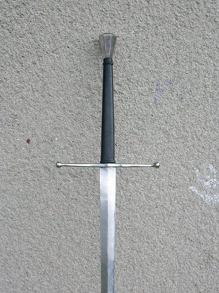

PostPosted: Mon 21 May, 2012 3:33 am    Post subject:         Reply with quote
A very nice replica, made by the below german maker:
http://www.dietraumschmiede.de/fecht/fecht.htm
 Attachment: 26.56 KB
 Attachment: 34.78 KB

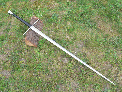

PostPosted: Wed 30 May, 2012 9:57 am    Post subject:         Reply with quote
And another castillon inspired sword by French swordsmith Gael Fabre.

PostPosted: Wed 30 May, 2012 12:39 pm    Post subject:         Reply with quote
Julien, thanks for this, an outstanding example. And in general, this maker has some nice looking swords. He does seem to like suede on his more modern looking creations.

Lukas MG
Location: Germany
Joined: 23 Feb 2010
Posts: 329
PostPosted: Wed 30 May, 2012 3:19 pm    Post subject:         Reply with quote
That German maker is Arno Eckhardt. I know him well, he lives close to my place and heat treats my long blades. Good guy. Doesn't make swords anymore though, only back pipes Big Grin
