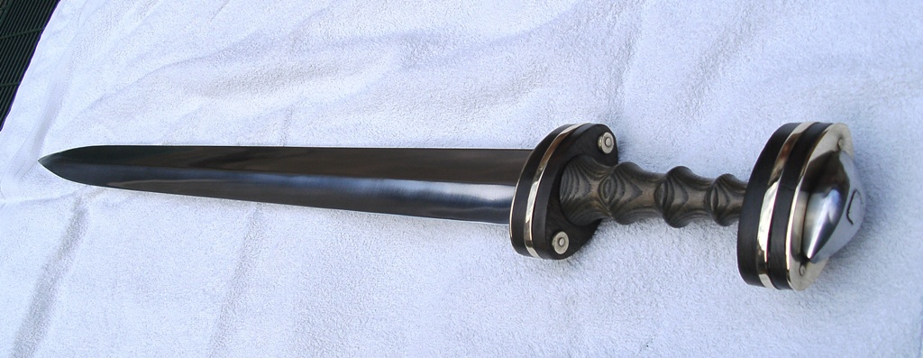

Here is a recently finished project.
Commissioned to me a few months ago.
Blade length: 74cm / 29 1/8 inch approx
Blade width: 4.6cm / 1 3/4 inch approx
Overall length: 89cm / 35.5inch approx
Weight: 1.9 pound
Blade of Hardened and Tempered Chromium, Vanadium .8 Carbon Steel. Hollow ground diamond section, semi sharp.
Hilt of Ash and Mahogany. Brass banding and fixings, with a steel cap and hot piened to ensure its sturdyness whilst being used.
A light and agile sword, which is exactly what i was after for horse back work.
Thanks for viewing.

Looks like a well made and attractive sword!
I am wondering about the cross-section of the blade though, as I was under the impression that a lenticular blade, possibly with one or more fullers would have been the norm.
I also wonder a bit about the size of the metal pommel.
Which historical blade(s) did you use as an example / inspiration?

You are quite correct regarding the 3 fullers in the top 3rd of the blade.
Due to budget of the customer these were not added.
Regarding the metal cap, the original is wood. I wanted and confirmed with the customer that I prefer to hot pein all of my 'useable' swords as this is the strongest and most reliant method of securing a swords components.
If a customer required a brass locking nut I would happily have used this method.
Being confident that peining is stronger than a brass locking nut in effect. I wouldnt have been able to hot pien if the end cap was wood, therefore a much more hardwaring sword is made using this method. In my opinion anyway.
All in all I am confident that the sword is much less likely to come 'undone' during roman cabbage cutting displays and interpretations.
thanks for your feedback Paul.
