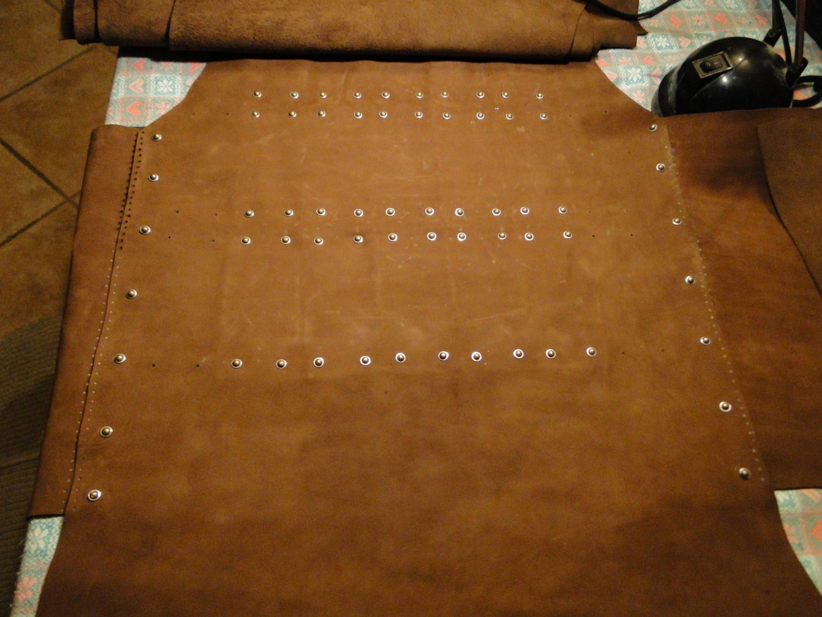

Location: Near Milan - Italy
Joined: 19 Jan 2011
Reading list: 8 books
Posts: 59
PostPosted: Sat 21 Jul, 2012 6:25 am    Post subject:         Reply with quote
update... only four plates missing on 2nd and 3rd row; I left a little room for side stitchings for which I was drilling holes in advance
 Attachment: 198.45 KB
