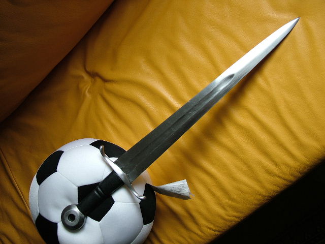

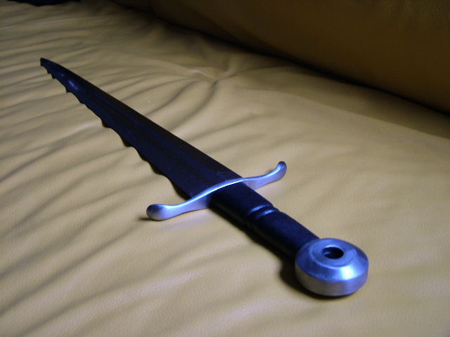

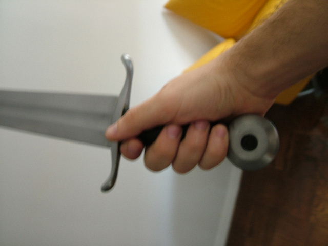

I finally received the Coustille sword and I was very quickly reminded why Windlass products are low on the food-chain.
Having handled only Albion's stuff and my Atrim recently, some of the flaws on the Coustille made me dissatisfied with the product but I had to remind my self that this is the reason it is cheep. Now that I have gotten over it I think that is might be money well spent.
It is hard to talk about heft on a 23in weapon but I will try to convey its characteristics for those interested. The sword (or maybe I should call it dagger) feels light in the hand and rather comfortable albeit the grip being a bit too narrow for my hand.
The POB is 1.75in from the top of the guard. The blade does not feel that it could deliver a powerful stroke. Maybe it is not meant to be used in a striking/cutting fashion. That changes if I slide my hand and grip part of the pommel as a swing ( that moved the POB away from my hand) and the sword feels a bit more hefty. I can quite easily align the sword in a cut and hear the gratifying "woosh" as I swing it. I think a smaller (lighter) pommel could improve the heft of the sword.
The point of the blade is needle sharp but that cannot be said about the edges (I think it is the standard that the Windlass blades some unsharpened). The is no distal tapper until after the fuller finishes. The blade is VERY stiff, which together with its sharp point makes it pretty good for trusting.
The hilt construction is still a mystery to me . The pommel does not have a nut so I think that it is directly screwed on the tang. The drip is leather over wood. The problem is that the wood can be seen under the leather where the seam if the grip is. Nothing terrible but it is there. Somehow I get the feeling that the tang will not handle cutting. I will try cutting soon enough, but if anyone has experience (good or bad) with this sword please tell me before I irreversibly damage the sword.
The lines of the sword look great (IMO) from some distance. But upon closer inspection irregularities start to emerge.
The pommel's two faces are not symmetrical, for one. The blade when inspected under the right angles shows this waving on the surface. (luckily it is totaly invisible when looked straight on). There are no machining marks, however.
The lines of the fullers are not as crisp as on the picture, but the fullers is straight and it ends at the same place on both surfaces of the blade. The Fade of the fuller is nice and gradual.
Now that I have stripped the liqueur (few hours of scrubbing with sand-paper) I can start sharpening, aging, and finishing the blade to my likes.
The recess in the pommel is nice in the sense that I can insert something there to add "character" (coin reproductions for example).
I particularly like the shape of the guard, as the smooth lines make it attractive. The swelling of the ends of the guard is very nicely done.
If the tang is of a decent construction, the $108 I spent on this sword will be well worth it, as it will give me the joy of experimenting with aging an what not and still having a tool that can do its job. The scabbard is VERY loose but that is nothing new.
Few picture follow (I apologize for the quality but I had limited light and did not want to use flash). Bear in mind that the sword is not finished properly yet (polished only with 250grit sand-paper)

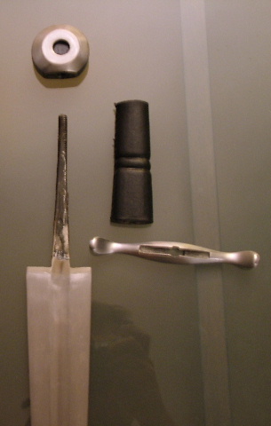

The pommel did come off easily. Here is a pic. Not the beefiest tang that I have seen, but it might hold (or not).
Alexi

Joe Fults
Location: Midwest
Joined: 02 Sep 2003
Posts: 3,646
PostPosted: Sat 06 Nov, 2004 1:02 pm    Post subject:         Reply with quote
Alexi,
Could you post a picture of the blade shoulder, assuming the guard will come off?

PostPosted: Sat 06 Nov, 2004 3:09 pm    Post subject:         Reply with quote
Joe Fults wrote:
Alexi,
Sure. One comment: I can bend the top of the tang with little effort Eek! Don't know how much of a problem that will be in term of performance.
Alexi

Joe Fults
Location: Midwest
Joined: 02 Sep 2003
Posts: 3,646
PostPosted: Sat 06 Nov, 2004 11:06 pm    Post subject:         Reply with quote
Interesting.
Does not appear to be a stub welded on, and yet they appear to have done a poor job with the shoulder. Would shaping it to avoid stress points have added that much to the construction effort? Probably would not have hurt production time/cost to leave a bit more meat on the tang either.
How much effort does it take to bend the tang?
That does not sound great IMO.
If you got this one from MRL maybe you should see about a swap?
