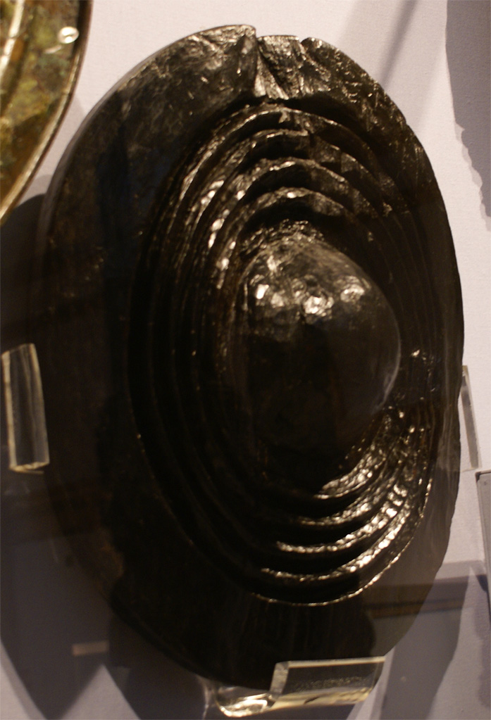

I've attached some photo's from:
- The display at the National Museum of Ireland
- The Clonbrin leather shield
- The Cloonlara shield mould
It's a great museum for anyone interested in weapons, and in bronze age weapons in particular.

Matthew Amt
Posted: Wed 07 Dec, 2011 7:22 am Post subject: |
Oh, neat, there it is! The object at lower center, from Cloonlara, is not a mold but a shield itself, made from a single slab of wood. Here's mine:

Paul Hansen
Posted: Wed 07 Dec, 2011 12:24 pm Post subject: |
| Matthew Amt wrote: | | Oh, neat, there it is! The object at lower center, from Cloonlara, is not a mold but a shield itself, made from a single slab of wood. |
Hmm, the museum clearly lists it as a mould... There must be some different opinions on it...
To me, the mould theory made sense: the thing is quite thick, at least several centimeters, and therefore must be quite heavy, unlike the bronze and leather shields. It's also quite crudely finished, which is unusual for bronze age weaponry.
I've attached a side view of the Cloonlara "item".
Attachment: 177.6 KB

Posted: Wed 07 Dec, 2011 12:48 pm Post subject: |
I think the real trick to knowing whether it's a mold or not would be to know what the back side looks like. There would be no need to hollow it out if it was a mold meant to be pressed against from the front. If the umbo is hollowed, it's far more likely to have been meant as a functional shield.

Kel Rekuta
Posted: Wed 07 Dec, 2011 1:40 pm Post subject: |
I'm pretty sure that press is described in Waterer's "Leather and the Warrior". It likely had a positive that mated to it to produce shields more efficiently. Its not like they had tacks to hold the leather in place as it dried. Wood pegs would have been recognizable in the surface.
Not really my area though, I think the article Christian linked above is the best discussion I've seen on this topic.
Matthew Amt
Posted: Wed 07 Dec, 2011 2:53 pm Post subject: |
| Paul Hansen wrote: | | Matthew Amt wrote: | | Oh, neat, there it is! The object at lower center, from Cloonlara, is not a mold but a shield itself, made from a single slab of wood. |
I've attached a side view of the Cloonlara "item". |
Oh, another neat photo! I hadn't seen the tool marks so clearly before. Rats, I made mine too nice! Mine is indeed heavy, but it is apparently ash while the original is alder, a much lighter wood. Plus mine may be too thick, at least a little. So I suspect the original is manageable, as a shield. (But boy, plant this sucker in someone's face and he's going DOWN!)
If they are thinking that this is a "positive" form or half of a press, I suppose that's possible. It does have a hollow boss and a handle,
http://www.larp.com/hoplite/Cloon11.jpg
But I really think the boss is too tall for it to be a mold for leather--that's really a LOT deeper than the boss on the Clonbrin shield, and as I understand it just dishing out the leather that deep was a challenge. The crudeness doesn't bother me, either it was simply a cheap shield (and I've seen a surviving axe handle that still had bark on it!), or perhaps it was intended as a votive from the start, which would explain the weight as well. The other surviving wooden shield is much nicer, and apparently thinner, too.

Jeroen Zuiderwijk
Posted: Fri 09 Dec, 2011 4:12 pm Post subject: |
| Matthew Amt wrote: | | But I really think the boss is too tall for it to be a mold for leather--that's really a LOT deeper than the boss on the Clonbrin shield |
Hi Matthew, the boss on the Clonbrin shield is pretty much exactly as high as on the Cloonlara shield. I remember seeing it from the side in the museum, and was surprised at how high the boss was sticking out. That doesn't show in any of the pictures have. The boss is also a separate piece, which as been stitched on. I've read mentions that it may have been a repair, but it could also just be to enable such a high boss, which would be very difficult if making the shield from a single piece.

Paul Hansen
Posted: Sun 11 Dec, 2011 3:28 am Post subject: |
| Jeroen Zuiderwijk wrote: | | I remember seeing it from the side in the museum, and was surprised at how high the boss was sticking out. That doesn't show in any of the pictures have. | I've attached a pic of both shields side by side.
For good measure, I also included the bronze shield from Lough Gur (which I rotated upside down).
