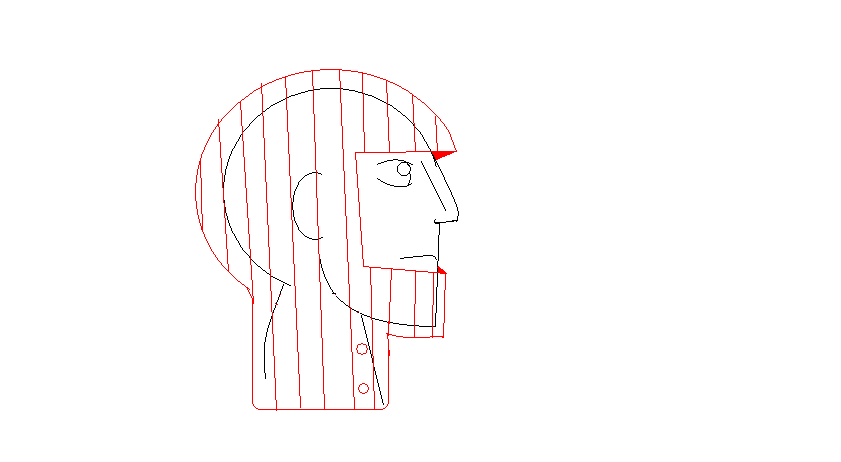

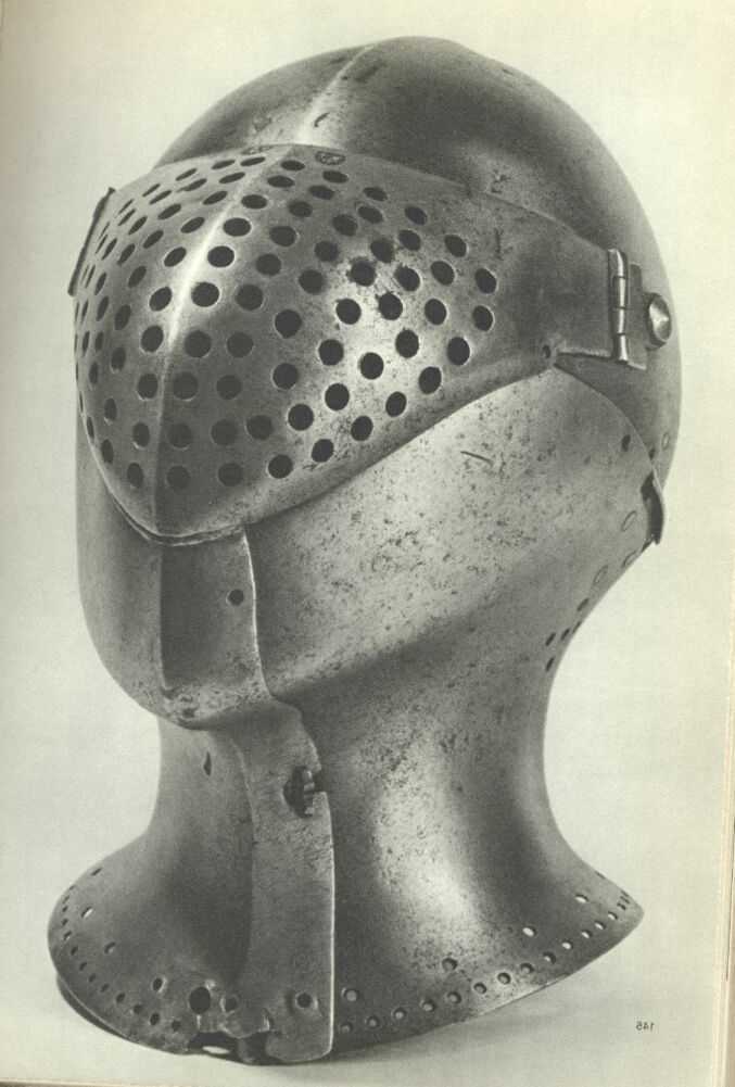

PostPosted: Thu 12 Jan, 2012 9:37 pm    Post subject:         Reply with quote
It makes me wonder how thick padding was underneath something like an armet or close helmet.
I guess in relation to people using "too thick" padding, as pointed out in period padding wasn't what (well, at least I wouldn't) one would call thick, but that's because I assume they'd move around a lot more then people do today.
I've recently made a stuffed liner for a very particular style of helmet, I'll see if I can take pictures of it and post it. I fear it may be over kill a bit.
Edit: Okay, so, I can't get a camera any time soon, so I hope this crude picture will help convey what I mean.
 Attachment: 6.73 KB
Stuffed. 2cm thickness on average. [ Download ]
 Attachment: 48.66 KB
For this style. [ Download ]
