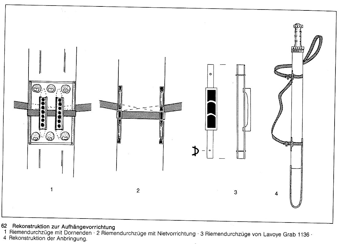

A simple loop running around the scabbard, fixed to a belt/baldric (as in the scabbard that Johan provided a link to....pyramids can be utilised to provide a similar effect)
A single or multiple scabbard runners, thorugh which a belt or baldric runs. Again pyramids (or buttons/bosses) can be utilised on such a system to prevent the free movement of the scabbard on the belt)
A strap running across the front of the scabbard which is connected to a belt running across the back of the scabbard. Connection can be made by stitching, by nails that run through both straps, by nails that run through both straps AND the scabbard. Some scabbards have copper alloy edge reinforcements to help with this.
Single or paired studs/buttons/bosses fixed either into the face of the scabbard or onto a tight fitting loop. These buttons go thorugh slits in the belt/baldric.
These are, I think, the commonest methods. You can find examples of some of these in my photobucket album:-
http://s418.photobucket.com/albums/pp263/medi...d%20stuff/
and there are some drawings of the various methods in Menghin's "Das Schwert im Fruhen Mittelalter", which Peter Johnsson posted some time ago:-
http://www.myArmoury.com/talk/download.php?id=17502
http://www.myArmoury.com/talk/download.php?id=17501
http://www.myArmoury.com/talk/download.php?id=17500
http://www.myArmoury.com/talk/download.php?id=17499
Then there are the eastern two point suspension systems....which is another subject altogether.

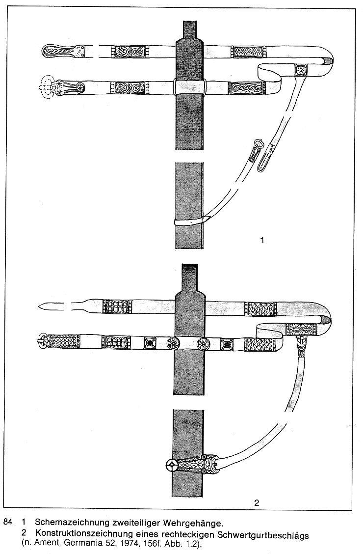

Matthew,
Would this be what you are referring to?

PostPosted: Wed 01 Feb, 2012 4:25 am    Post subject:         Reply with quote
Not really. A lower slung belt with a secondary suspension will angle the scabbard forward which keeps it free of the legs but it makes for a loser fit as the belt sits on the hip rather than being tight to the waist.

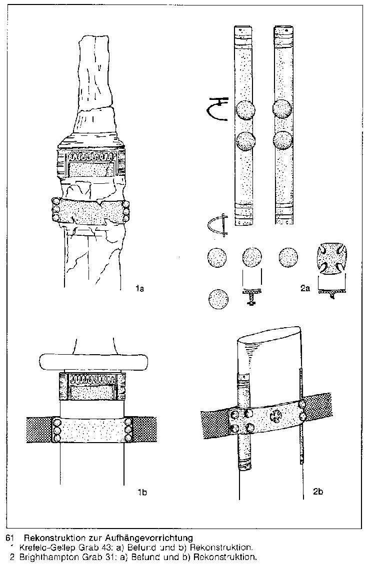

Fixing a tight waistbelt to a scabbard using a system like the Krefeld Gellep Grave 43 or 31 will ensure a scabbard that is tight to the body and which won't move around on the belt.
You could utilise the same mouting method on a baldric rather than a wasitbelt but then you need a secondary waistbelt over the top of the baldric to keep the whole rig form moving around..
