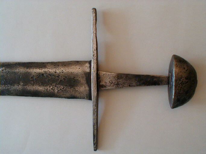

I contacted Jeff Helmes, after seeing the fantastic job he did on JD Crawford's sword recently, about making a sword for me. Jeff was great about communication, we had some great email volleys about his methods and the prices of his work. I decided on a sword and it was set. Then I changed my mind after seeing pics of a sword I hadn't seen previously. It was a late viking sword, which is my favorite, with a B.1 pommel and a thin style 1 cross. I hadn't seen one like it so I decided to have it made. Jeff and I had talked about doing an iron core with steel edges for the previous sword which I liked the sound of. The new sword I decided to have made also has INGELRII inlay. Jeff said we could do both the iron core and inlay which sounds too cool to me! So, it was decided! Here are pictures of the original:

The fuller edges look a bit "soft" to me. What are your opinions on this?
I like to see swords made with more soft fuller edges from time to time if it is consistent with the original.
Or are you thinking that this would be due to corrosion than the original shaping?
Is that an inron/steel inlay or silver? I believe INGELRII were iron but. . . . .

I think the softness of the fuller edges might have to do with how this sword was cleaned. It looks to have been subjected to some pretty harsh methods which may have softened it up a bit. The inlay will be pattern welded rod.

Regarding the roundness of the fuller edges, it is something I've seen before on similar swords. It could be due to cleaning / "restauration", but on the other hand the production process was different from what we are used to nowadays (CNC...) and it makes sense that on originals the fullers are not so crisp and well defined as what we are used to in the higher quality reproductions. Uneven and wavy fullers are another example of this.

It might be interesting to take a look at other INGELRII swords to determine the shape and definition of fullers on those examples. Maybe you could, sort of, "cross-check" regarding the sharper fuller edges you are looking at executing with this one. Of course, determining if said INGELRII sword was from the same wokshop as the piece in question would be impossible, but it may inform your choice, or possibly challenge it, if you see more examples with either hard/distinct or soft edges that haven't been so aggresively treated as this one.
I certainly don't have a dog in this fight- and I'm not challenging your opinion here. I have just began thinking a bit more about fuller definition in period and wondering about how much variety could have been seen at the time.

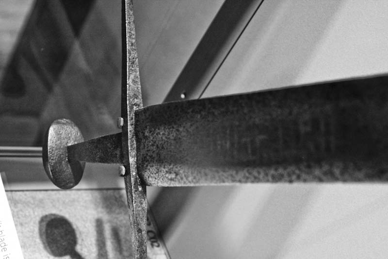

Records X. 9, which has a similar hilt but a somewhat different blade profile, has an even less well-defined fuller. The fuller widens noticeably at the INGELRII inscription. I have no idea what cleaning preceded Oakeshottís lemon juice, vinegar, and Worcester Sauce bath, but the rounded lines of the fuller are a striking contrast to the sharp lines of the cross and pommel. I would have difficulty believing that, at least on the Glasgow sword, the soft edges are not original.

I think the crisp fullers look better, especially with inlay. There's a case to be made for either side.
