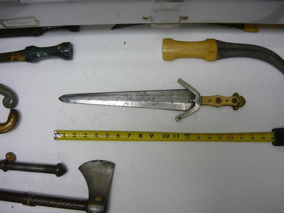

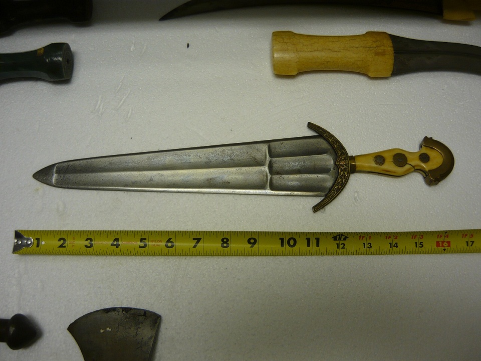

A few photos...Looking for help! Thanks!
 Attachment: 223.1 KB
 Attachment: 226.19 KB
PostPosted: Mon 09 Jan, 2012 3:00 pm    Post subject: Re: Cinquedea?         Reply with quote
Yes, but help for what ? Identification, more pics of other cinquedea, historical context, a custom maker who could make one for you etc .... ?

Jean, Local Museum has a collection of edged weapons that have been in storage for years. My knowledge of edged weapons is limited at best. I volunteered to help research the items.. Looking for Identification, dating, historical context. 14 items total in the collection. We plan on displaying the Items this spring. I will be uploading more detailed photos of the individual items. Thanks for the response!!!

My gut reaction is that they are not original pieces
They do not have the finesse that these pieces usually do.
The second piece has a tooled guard, but there is nothing on the pommel - doesn't look right to me.

I second that, they both look like reproductions from the same maker. They seem off and lack the form and detail of originals, especially the second piece for the reason Tod gave, but even the type of embelishment on the guard makes me wonder....

It's hard to tell from the photos, but those blades have the look of some 19th c. pieces that were treated with acid to mimic the corrosion of centuries.
It's important to note that 19th c. arms and armour reproductions are collected for their own merits, and sometimes command high prices at auction. http://www.myArmoury.com/feature_schmidt.html
Those that are done well can still be used to represent the given type in exhibits as long as they are correctly identified and, ideally, if their variance from originals is pointed out. Many a fine museum has composite armour and arms, with original parts long ago married to 19th c. parts for aesthetic or commercial reasons. Wallace Collection, for one, still displays such but clearly describes these in published notes.
