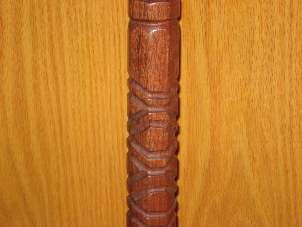

I've done this myself, but with a walking stick: Had the lumber yard cut up a plank into squares and then planed them octagonal: Not as long as a polearm haft but on the other hand the wood was extremely hard Macassar Ebony and the job was done by hand planing, no power tools, lots of patience and eyeball ..... Wink Razz Laughing Out Loud
As to long and thick poles I found some very thick diameter ones, at a local to me, speciality wood suppliers: Mostly up to
1 1/2" diameter Ash or " mystery " hardwood as the lumber yards at times don't identify the woods they use to make dowels.
I haven't bought one yet, but at the same wood supplier there are 1 3/4" diameter White Oak poles up to 10' long that are for staircase railings: You might look into lumber suppliers that offer these very oversized poles that you could also taper in interesting ways. Question
Pics are of another stick I made recently: The main shaft is Jatoba and was 1 1/2" square, planed octagonal and then carved with files, top end is African Ebony and even harder than the Macassar Ebony.
Anyway, the point being that even though the piece is a lot shorter to work on than for a Halberd haft the woods are about 3 to 4 times harder than Ash or White Oak and the wood for your halberd would be much easier and faster to work.
But if you can do the making octagonal with power tools you would be able to make it round if you wish with rasps fairly easily and finish with finer and finer grits of sanpaper.

PostPosted: Fri 30 Dec, 2011 7:55 pm    Post subject:         Reply with quote
Bryan W. wrote:
Not to hijack the thread but Jean if you made that........great work!
Thanks, and yes I made it. Big Grin
And yes lets not hijack the thread as I mostly wanted to show that one can get from square to octagonal with hand tools if one is patient and persistent, and from octagonal to round is even easier. Wink
Oh, one can also use a spokeshave which is like a cross between a plane and a drawknife but with more control over the depth of cut than a drawknife that can be too aggressive and risks digging in too deep if one isn't careful.
http://en.wikipedia.org/wiki/Spokeshave
http://en.wikipedia.org/wiki/Drawknife
Note these tools are also really useful in tapering a haft to fit into a spear or polearm socket.
