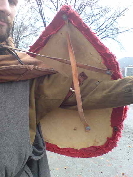

Brian; You could simply add cavalry straps to your wedge shield, as a start. Most of my shield grips start out being stapeled to the back of the shield in order to find a good configuration before putting nails in.
