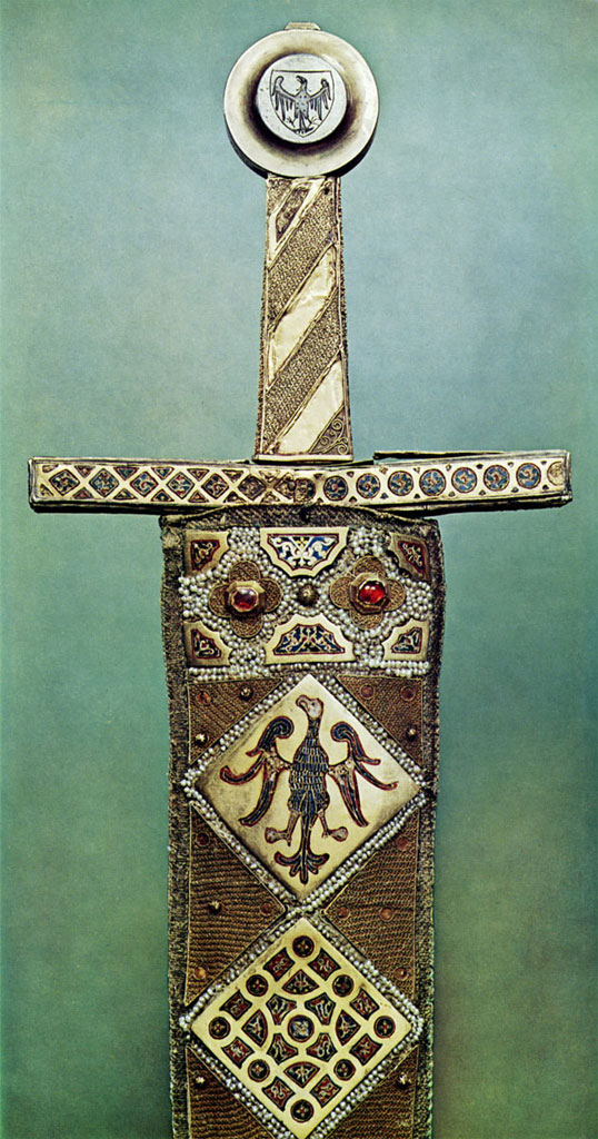

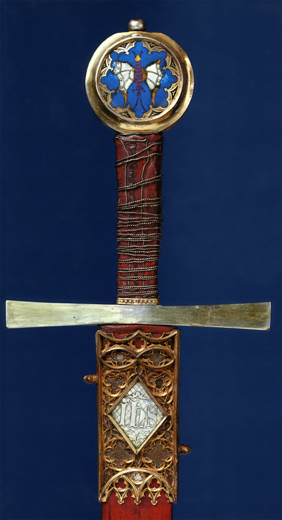

Basically any heraldic device could be engraved, inlaid or enameled on the pommel, probably accompanied by gothic scroll-work or other decoration on pommel and cross.
Simple devices work best, obviously, as they are easiest to make and better to recognize even when small. For instance, the sword of Edward III of England (http://www.myArmoury.com/review_aa_edwardiii.html) has a rather complex coat of arms, where the sword of Frederick II of Germany just has the "plain" Imperial eagle, which also appears in slightly different shape on the scabbard (see attachment).
On the other hand, another sword called "sword of St. George" (see other attachment), has the rather unusual image of a butterfly...
So, any "normal" heraldic device (including crosses) you fancy may be placed on a pommel, but devices not normally found in heraldry may apparently be historical as well. As far as I know, heraldry on swords is by no means limited to royalty, but may be applied on swords by anyone normally entitled to arms, including cities and other civic bodies.
Do you jave any idea of the scabbard is contemporary to the sword, and that it is contemporary to Frederick II? I suppose the Sword of Frederick II is located in the Schatzkammer in Vienna?

Paul Hansen
Posted: Mon 24 Oct, 2011 11:02 am Post subject: |
I've attached the caption. To be honest, I have no idea what book this came from...
The pommel is apparently a replacement from around 1335. Too bad... I wonder what is exactly known of the original...
Attachment: 76.4 KB
