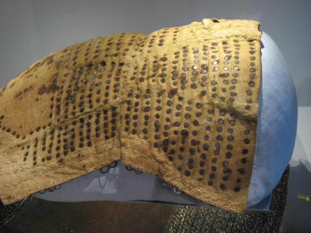

PostPosted: Sat 24 Sep, 2011 12:30 pm    Post subject:         Reply with quote
You may be interested in this piece of armour. It's from Polish Army Museum in Warsaw. Dated 1380-1420. Made of metal plates and covered with hemp cloth.
[url] https://picasaweb.google.com/105442445371445018217/MuzeumWojskaPolskiego#5593932058908377042 [/url]
[url] https://picasaweb.google.com/105442445371445018217/MuzeumWojskaPolskiego#5593932226249514738 [/url]

PostPosted: Mon 26 Sep, 2011 2:30 pm    Post subject:         Reply with quote
I would love to know more about how this piece was dated. It is very similar to a coat which I believe is in Milan.
I understand that the Milan coat is considered by some to be mis-dated and is likely later (15th - 16th century?) Personally I would like to see supporting evidence for the style to be late 14th Century as I think it make lovely reenactment armour.
m
 Attachment: 139.13 KB
