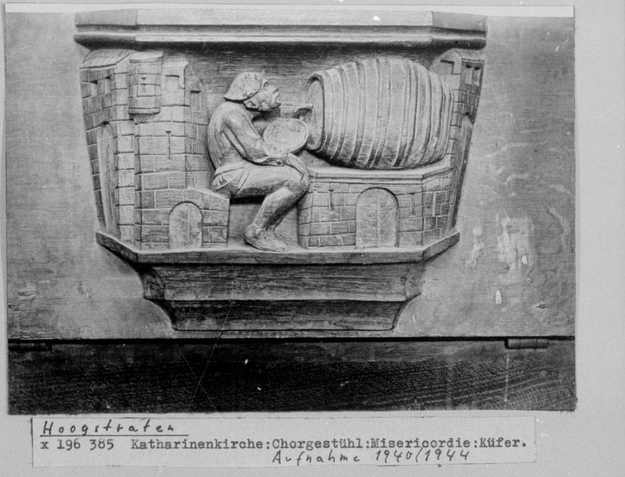

A misericord in a choir stall, circa 1532 http://www.bildindex.de/bilder/be00098f03a.jpg
 Attachment: 19.57 KB
 Attachment: 112.03 KB
