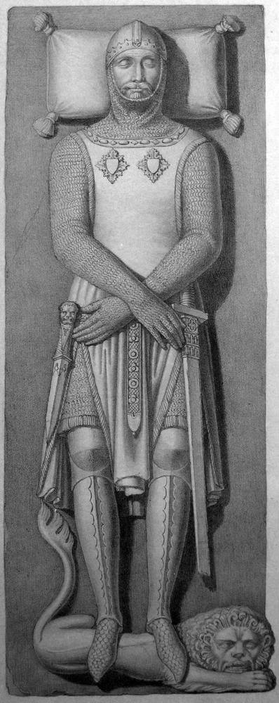

Depections or mail gloves tailored to individual fingers are fairly prevalent in sculptures and in artwork. Has anyone tried to make or wear gloves (integral to sleeves or otherwise) of only mail links or of lined mail links? How well does this work? is grasping a weapon something of an issue? I would think that the mail would likely be of finer dimensions per ring for gloves, but the sculptures and effigies (admitedly somewhat stylized) do not seem to bear this out.

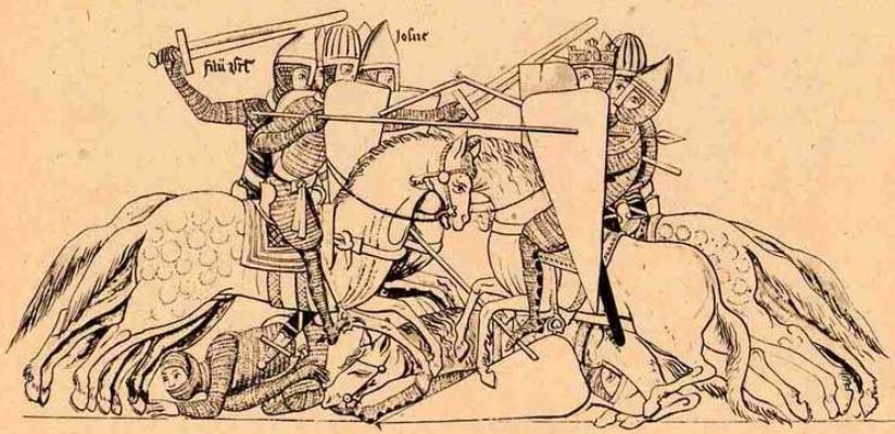

The samurai used mail lined gloves (kusari yugake), with the mail exposed and also with the mail hidden by a layer of cloth.
I've seen the dueling glove above, but I was wondering if there were any attempts to recreate the seemingly (likely lined) full mail cover gloves like these:
Just a few examples
