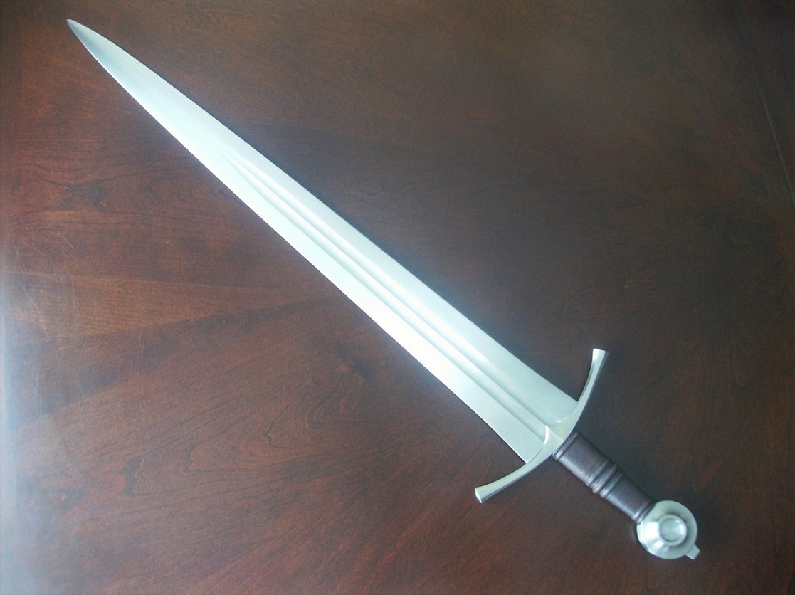

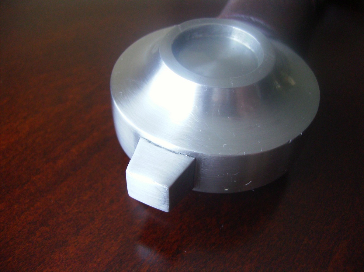

I was cutting a few water bottles in my back yard the other day and my Albion Sovereign slipped out of my hand, landing on a paving stone pattio. Two small dings on the pommel and two areas of damage on the side of the blade that has the "Albion Mark".

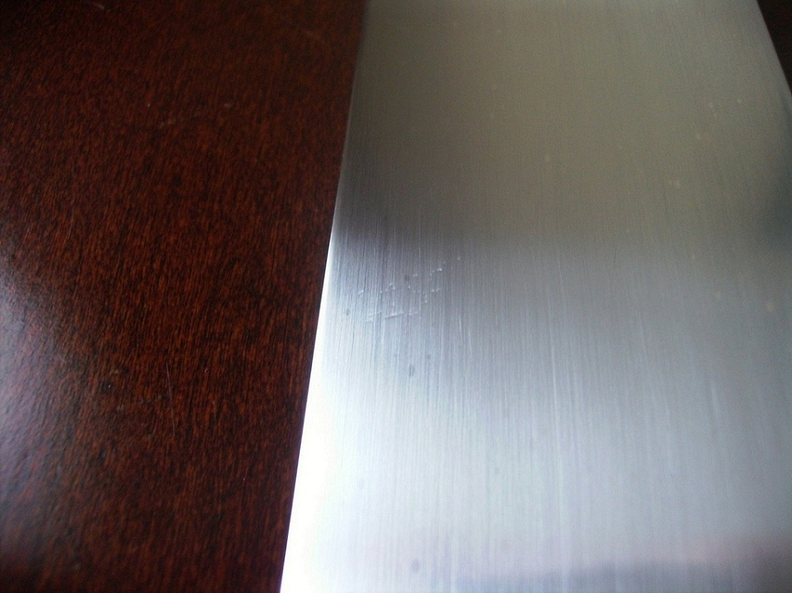

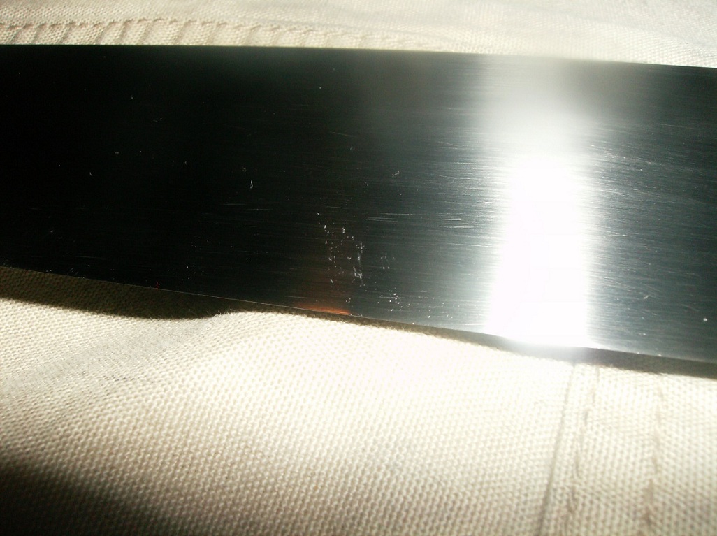

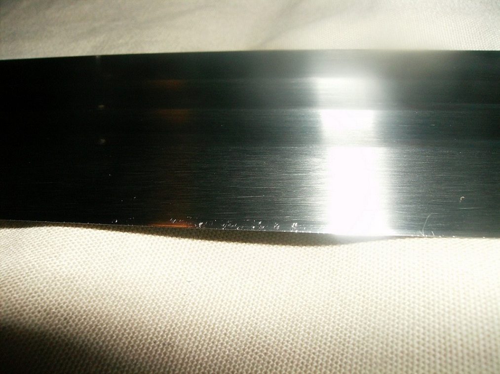

The first area of damage is a series of dots impressed into the appleseed bevel, not quite reaching the actual edge but it is a close thing, four inches below (toward the hilt) the CoP. These dots are spread out over an area about two inches.
The other area of damage is a scuff about the size of the nail of my fifth digit one inch above the CoP.

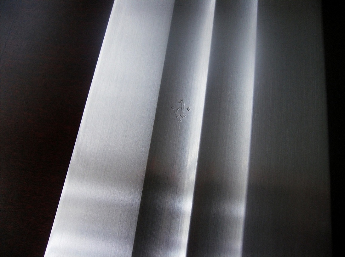

I have spent about four hours polishing the blade with a light grey scotchbrite pad. The marks are no longer black inside them, but shiney like the rest of the blade.
While trying to photograph the damaged areas I figured out realy fast that it is very difficult to shoot polished steel.
So I moved back and began taking full photos then woorked closer as I got more of a feel for angle and light.
Here are some of the pics I ended up with using indirect natural light and then a few flash efforts on the repair bench.

Well considering all that potential of that which occured, it looks fantastic actually.

Doesn't look too bad to me but certainly disappointing when this kind of damage occurs but any sword seeing any reasonable use will get some minor scratches or scuff marks, or at least they will look " minor " after the sanding you have done.
I guess it's a question of expectations: if you want a collection piece ( sword ) to stay completely unmarked it almost has to be kept under glass and handled only while wearing cotton gloves.
Well there are marks of use and then there is serious damage and deep notches which are a lot worse.
On the plus side, the sword is functionally 100% even with a few hard to completely remove scuff marks and the small dents in the pommel are best lived with. I guess you have to decide if this is going to continue to " bug " you or just get over it: The sword is now like a car that has lost it's "new car smell " or got it's first scratch on the paint job, or a chipped windshield from a piece of flying gravel. Wink Laughing Out Loud
Well, trying to make you feel better, not sure I'm helping much though ! I know I wouldn't be happy about it.

320 grit sandpaper on the blade, 220 followed by 320 if you feel bold. An Albion finish is actually two finishes on top of each other...the coarser finish topped off by a fine scothbrite finish. I'm not sure if it's 220, 320, or something in between, but either works well. Be sure to follow the lines and don't leave skitter marks at the edges. Use a foam block and wrap it in sandpaper. The scratches on the blade will probably never disappear but you can soften them a lot. Finish off with maroon or gray scotchbrite. Gray matches Albion's finish, maroon leaves a more satiny look that I prefer.
The pommel you can make nearly perfect, except you are going to reshape the crease near the edge where the dings are. I'd recommend just softening those as well.
If you are not good with polishing, don't have patience, or will cry once you start to sand your sword, don't do it. You can easily make the sword much, much worse.
With that in mind, my actual advice to you is leave it alone. It's a sword. It's not meant to stay perfect and pristine. It actually looks pretty good. Soften the scratches with gray scotchbrite (or maroon). It's safe and won't damage anything and if you screw up you can polish it out (still using the scotchbrite) very easily. Just keep in mind scotchbrite will dull your edge very quickly.
Or, just send it back to Albion. They can fix it for you.
