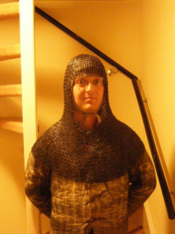

The fit wasn't very good though. It was big, far too big for me. I'm not exactly small (1.82 meters, normal build) but I drowned in it. See the attached pictures. But, that's exactly why I ordered the tools and 2000 extra rings for (well, that and for making maille gauntlets. But hat will be another thread).
Attachment: 99.8 KB
Original, front
Attachment: 100.14 KB
Original, side

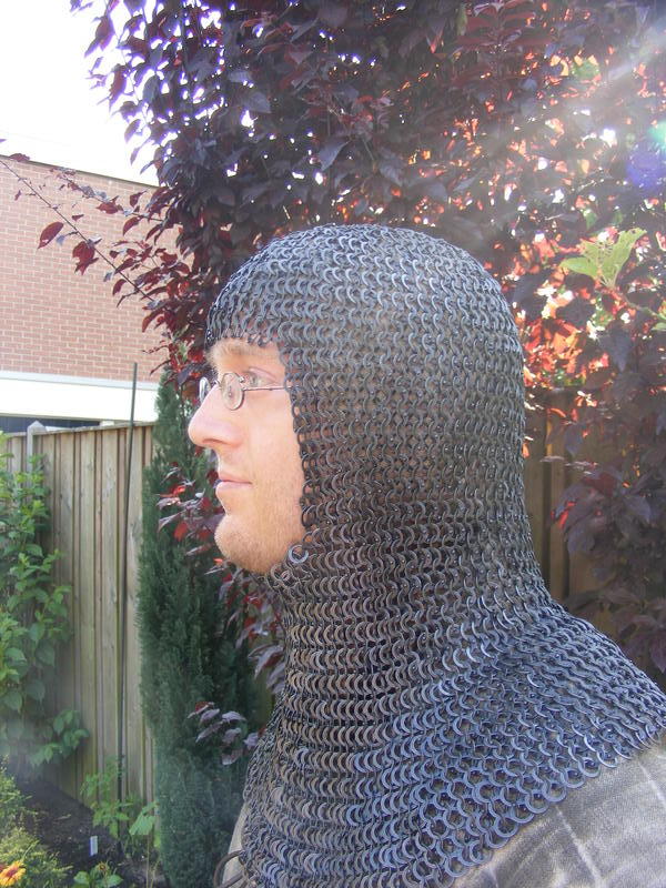

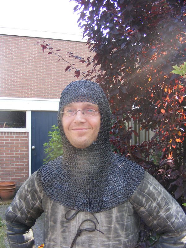

Here's what my coif looks like after the first weekend of work. I started with trimming the mantle. I'm not very broad shouldered and the mantle was sticking out beyond my shoulders quite a bit. When I trained with the unmodified coif during my last WMA training it flopped around quite a lot. I trimmed off 9 rows of rings so that the mantle would come to about the edge of my shoulders. This also gave me a strip of maille that I can use for other things, like filling in the gap up to my chin. It's also a source for solid rings. The coif is half solid rings, half riveted rings, but I only ordered riveted loose rings.
Next up I started taking in the neck. My original plan based off my old thread was to take it in as far as I could and run a slit up the back so I could fit my head through. However, I noticed that while taking in the neck that I couldn't take it in too far. The standing collar on my gambeson meant that my neck wasn't all that smaller than my head. In the end the neck opening barely fits over my head so I don't need a slit in the back. The upshot of that is that I don't need a squire to lace me up I took in 8 columns from the side and back of the neck. Then I took another piece out from the front of the neck and mantle, reducing the entire circumference.
Lastly I filled up the gap below my chin with segments from the mantle trimmings. At first I filled it in quite high, up to my lips almost. Pretty much similar to this original from Gotland. I thought that with such a small opening, I might even get away without adding a ventail, but that felt quite uncomfortable against my chin and cheeks. So, I heightened the opening again so it fit closely against my jaw. Later on I will add a side ventail that will cover my chin and mount (and maybe nose) but I'll need to do a bit more research for that and order some leather.
And here are some pictures of the end result. Still to do: a ventail and leather lacing on my brow line. I'll take it out to WMA training again next Friday and see how well this fits when in action.

Tailored, front
Attachment: 132.46 KB
Tailored, side
