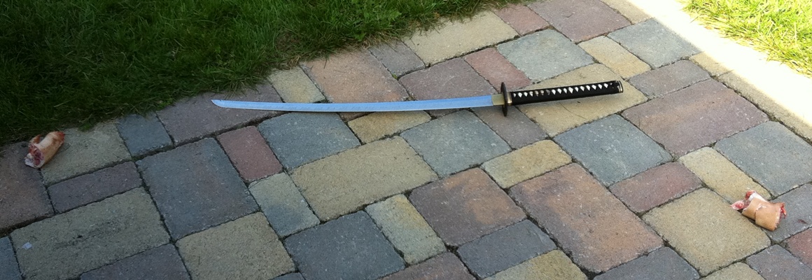

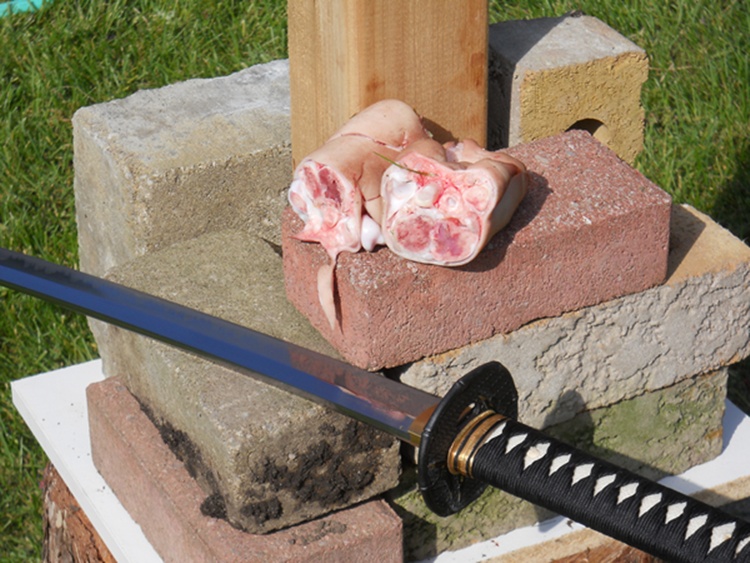

My only limitation when performing these cuts is that I intend to stay within what I was taught, hence I try not to overextend myself and likewise finish my cut in as favorable position as I can in case my opponent strikes back. For example, perhaps you are familiar with the Zornhau - this is the strike I performed on the pig leg. This strike limits the starting position of the blade to no further than your shoulder and you need to finish the strike so that you point ends up being not too far from your opponent (the pig leg in this case). This probably limits the force I can exert.
Here's a pic of the pig leg after a katana strike Happy
 Attachment: 184.78 KB
 Attachment: 211.23 KB
