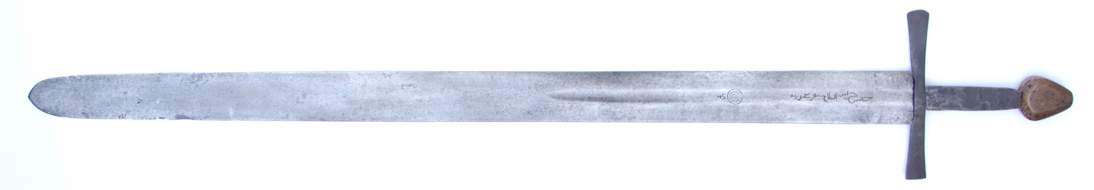

Ok, sorry to disappoint but the photos of the above sword are unavailable at present. However, I do have a pic of another XIIIb (also from the Alexandria Arsenal and now in a private collection) which I took great pleasure in having for a while in 2007. This one is of very impressive proportions and is slightly heavier, with the perceived weight (when held) being quite far down the blade. The point of balance is also further towards the tip when compared to the sword above.
Measurements are as follows:
Length overall: 111.75cm; Blade length: 94.8cm; Blade width: 56mm at the hilt, 51.5mm at the centre of percussion (again, only a very slight profile taper!); Blade thickness: 5mm at the hilt, 1.5mm at the centre of percussion; Span of crossguard: 18.1cm; Length of grip (a bare tang again): 10.2cm. Length of pommel: 5.5cm; Width of pommel: 4.5cm; Thickness of pommel: 2.2cm; Point of balance: 21.6cm from the crossguard; Centre of percussion:18-20cm from the tip; Weight: 1,382g (3lb 1/2oz).
As you can see from the photo, it has one of those unusual 'pear shaped' pommels. These were often thought to be much later replacements but enough examples are shown on fourteenth century effigial slabs (from Cyprus and northern Europe) to confirm that they are probably contemporary with the swords.
Attachment: 199.99 KB

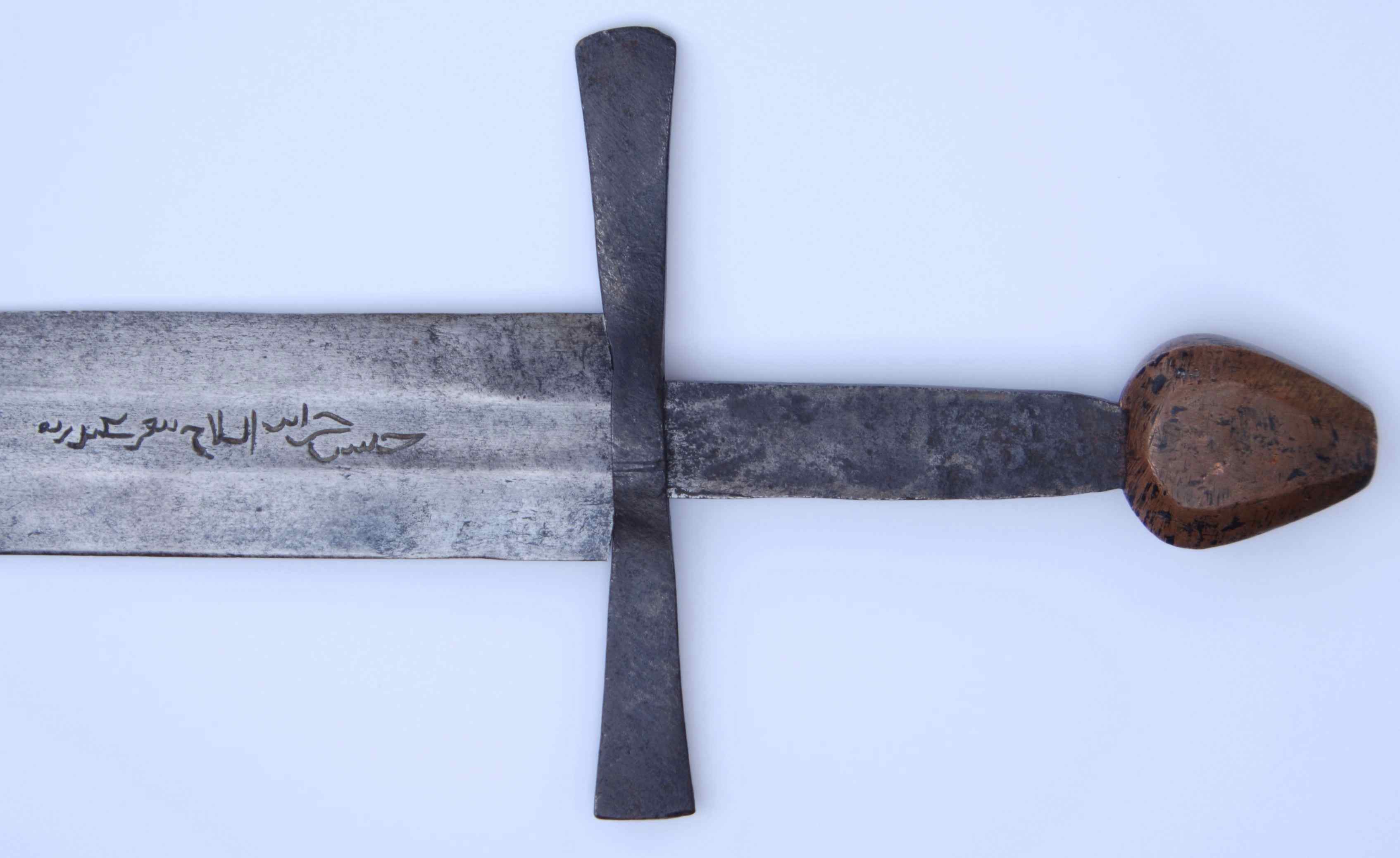

Apologies for the rather poor quality of the previous full-length photo. Here's a closeup view of the hilt. The Arabic inscription reads simply as:
"Donation to the arsenal in the frontier city of Alexandria"
There is no name or date on this inscription, but the "handwriting" and the type of blade suggest that it should be included in either the 1367-68 (Ukuz) or the 1368-69 (Sultan Sha'ban) bequests to the arsenal of Alexandria.
Attachment: 239.77 KB

Hi Cornelis, and thanks for the post.
The inscription on the sword that I posted above, while slightly unusual, does not really conform to those of the Faris bequest of 1436-37. One of the best indicators of this can be seen by comparing the "handwriting" of the Arabic word 'hubs' that begins the inscription (and which can be seen on the right in my photo, and at the top right of yours). Reading from right to left, this is composed of three letters: 'ha', 'ba' and 'sin' (or H, B and S, effectively, with no vowel for the 'u' sound). You'll see that the letter 'sin' is composed of two small ridges and then a longer 'hook-shaped' finial at the left end of the word in the earlier inscription.
On the Faris inscription, these ridges are omitted in favour of a single line. This is effectively for convenience and may be seen frequently in modern handwritten Arabic, and this practise was first introduced by the engravers of the Mohammed ibn Mahmud inscriptions on swords that can be dated 1392. There was a transitional period where both styles were used, but by the time of the Sultan Barsbay we no longer see the ridges on the letter 'sin'. Similar nuances in these hand-engraved inscriptions occur on other words as well, which can all help to date these inscriptions with some accuracy.
The type of sword can also help with dating its inscription, although this should not be relied upon as certain sword types can be seen to occur across several of the bequests to the arsenal (and there are 11 main bequests in total between 1367-68 and 1436-37). Ludvik Kalus included another bequest for the year 1439, but I think this can be discounted when you look at the handwriting of those inscriptions. The distinctive, broad Type XIIIb blades under discussion here all seem to have been donated in the 1367-68 and 1368-69 bequests, where they are dated at all, and the handwriting of those that aren't dated seems to match the dated ones quite well. I hope this makes sense!
An article I wrote for the Spring 2007 London Park Lane Arms Fair catalogue shows the differences in epigraphy for the word 'hubs' in all of the various bequests, and would probably be of further help if you can get a copy.
Once again, thanks for your interest in the subject of these inscriptions - I hope we're not going too far off-topic by discussing them!
