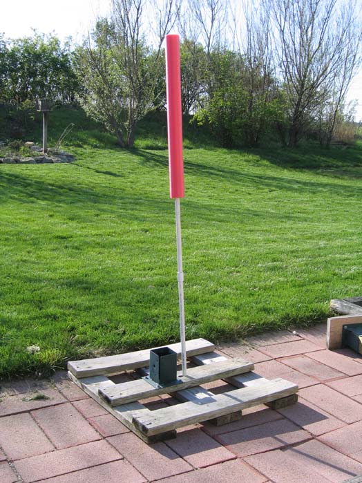

A relatively cheap, but easy to clean up, cutting medium are foam pool noodles. They're a little out of season in some parts of the country right now. :) Cut them in half (so they don't flop around so much). Stake them on a PVC pipe or wooden dowel and secure that pipe/dowel somehow.
I use the stand below, made of 2 x 6's with a hole drilled through two of them. I've also added a bracket to hold a 4 x 4, to which is bolted a platform for fruit/water bottles, etc. The whole rig is heavy enough that it won't be knocked over easily. But it's smaller thana shipping pallet, meaning you can get fairly close to it. It's no more than 3 feet wide in any direction (I think the boards are actually around 30 inches).
