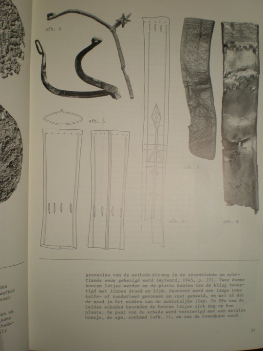

this a picture from the Veertiende Eeuwse Zwaardscheden Uit Leiden (a 14th century sword scabbard from leiden)
its a small publication by C. van Driel Murray.
the scabbards in this publication have a saddle stitch on the back.
the scabbard in the Leger Museum Delft (dutch army museum Delft) also has a saddle stitch on the back.
and a friend of mine who is a archeologist in leather mentioned the saddle stitch is the most common stitch in the netherlands for scabbards
ben

There are many ways in which period pieces were stiched, but what I just have started to realise is that there are regional differences in this.
In 'Knives and scabbards' (London), most pieces were done with a whip stitch and many others with a saddle stitch done to allow the leather to butt joint, so not with a raised seam.
It appears from Bens local knowledge that in the Low Lands it was common to saddle stitch but with a raised seam and from his comments in his own scabbard making thread this is what he has seen on all or most of the local scabbards.
I have just been reading 'sheathes, scabbards and grip coverings' which is about Finland, so the same sphere as the Low Lands and England and here it was very high use of saddle stitch with raised seam (I think from memory 90 something percent) basically the same method as the Low Lands.
So between England and these other two places quite a difference.
Whip stitch was common, saddle stitch was common, running stitch was common, but less so. I have not seen a cross stitch used historically but I would say it almost certainly was simply because it is simple, decorative and could easily be done, but obviously not common. Most of my stitching is done with a slightly unusual whip stitch because I find it quick, strong and it pulls the edges of the leather together butt to butt and I like that finish, sometimes I use a saddle stich, depending on the application and leather thickness. I don't suppose it was very different then - use the tool for the job combined with the makers personal preferance.
