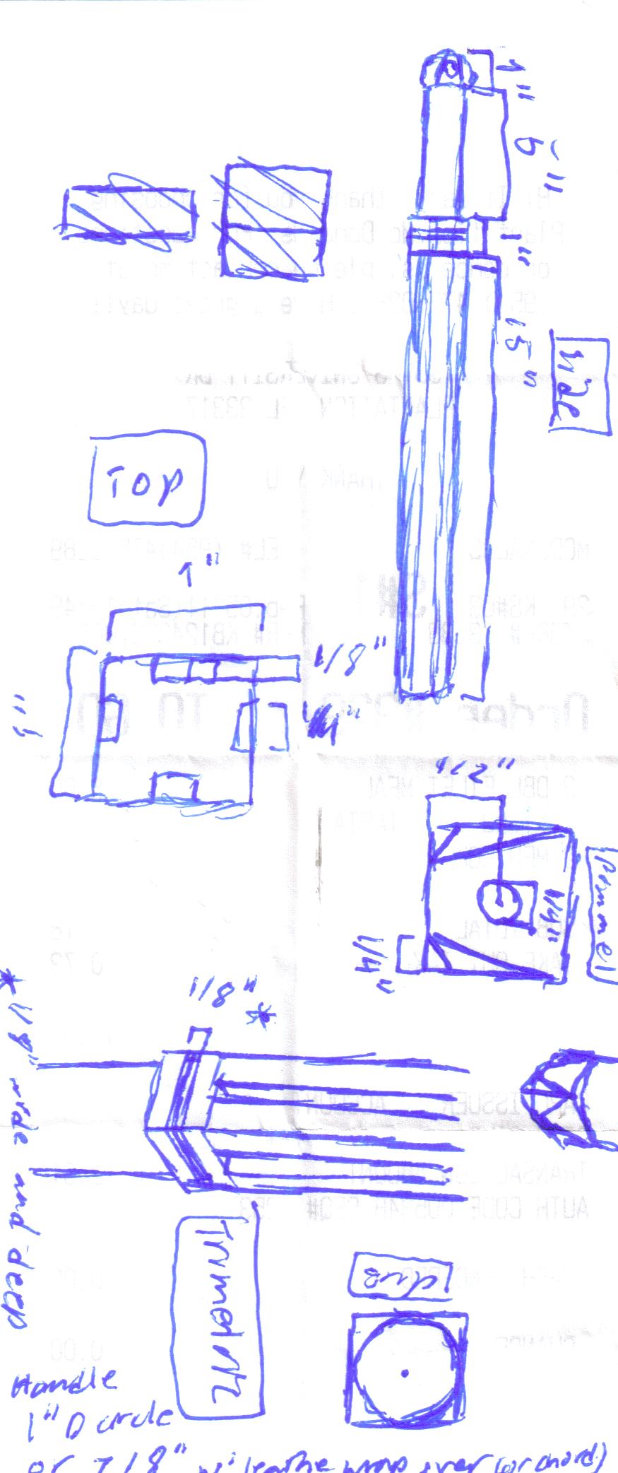

What happens when you have time on your hands and notice a piece of unassuming bar stock in your friends metal shop scrap bin. Big Grin
Just wondering if anyone thinks this is a good design. It isn't based on any particular period original and is a bit small in dimension, but I think it's be an effective ankle breaker Wink I'm thinking of making one out of aluminum, but am a bit concerned about durability and such. I'm kinda figuring on it being pretty safe and usable for safe live steel combat (thanks to not being the true armor crushing weight or mass) since the various fail points and hardness of 6061-T6 are

15in "blade"
width- 1in
length-1in
5in grip
22in overall (but negotaible)
Please post any encouragement, criticism, rants on lack of historical precedent, etc. Happy
 Attachment: 17.63 KB
3d mock up made on Google sketch up since I still can't get solidworks on my home computer
 Attachment: 164.02 KB
Seeds of inspiration. First plan drawn on the back of a McDonalds receipt [ Download ]
