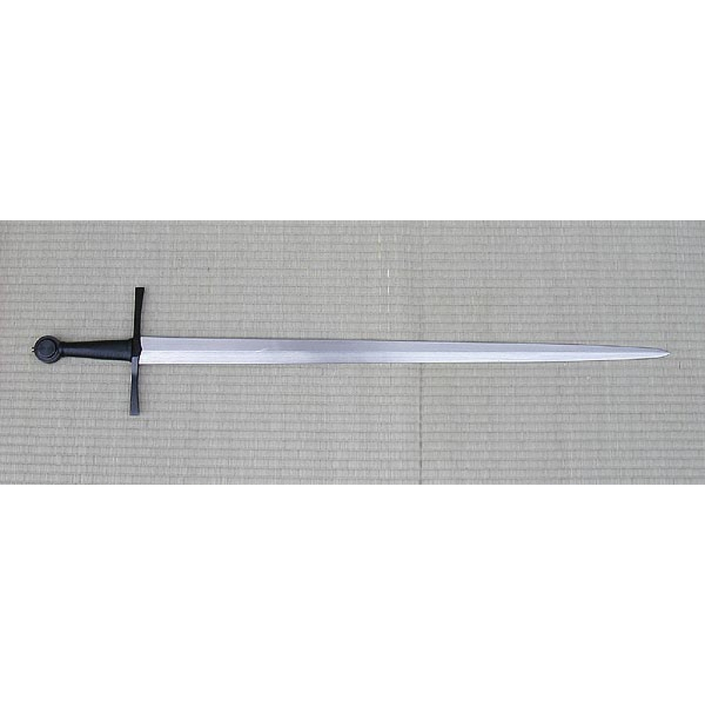

Hello,
I was wondering if this sword sold on the Tried and True Armory site would be good for a War of the Roses kit. Normally I wouldn't ask something like this here but I guess I'm more of an armour guy than a sword guy. I don't have too many pic's of swords, mostly armour but I think this sword looks 15th C. The site says it's 15th C but '1510' is also in the name so I just wanna make sure.
http://triedandtruearmory.com/econ/index.php?...duct_id=57
Sorry if this is in the wrong forum, but since it concerns a repro sword I thought it was best.
Thanks in advance for your replys and help on something I should really know myself.

1510 is an old Gus Trim sword model number. The 15 means 15th century, the 10's only meaning is to differentiate it from all the other ATrim 15th century swords.
That sword is a stripped-down, fairly nondescript looking type XVIII of the slender blade variety. ATrims are designed for performance over looks. It would pass without comment in the second half of the 15th century, except for the modern style pommel nut. It should be light, fast, and sharp - fine if you are not going to use it for reenactment combat.
Offhand I can't think of a 15th century singlehand blunt. If you need that kind of a sword, you might consider the unsharp Del Tin DT5150 for approximately the same price. http://kultofathena.com/product.asp?item=DT5150 - It is heavier and not as handy as the 1510, but it does look very good.

Thanks for clearing up about the '1510' roger. I'm not really looking for a blunt sword, I have 2 of those. I was interested in the 1510 because it was half the price of the Albion Burgundian which is the other single hand sword I was looking at.
I don't suppose it would be possible to fix the modern style pommel nut?
