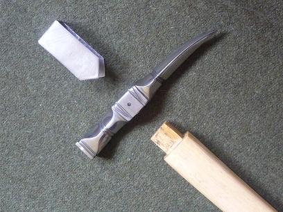

without directly answering the question I will add the following snippet of info.
Last year I had to make a some pieces of display for an 'armourers repair workshop' and as part of this I had a lance that I wanted to snap the head off as if it was in for reshafting. The shaft was 1 1/4" diameter (30mm) ash and I thought I would just snap the head off. In the end I placed the shaft between two logs and after many many targeted hits with a sledge hammer I snapped the shaft. I strongly doubt that a decent ash haft on a war hammer would rapidly suffer terminal damage from cuts so I would say it is either for long term life extension or for attachment of the head, but in the short term of a few skimishes I would say a shaft would not break even if struck a few times.
