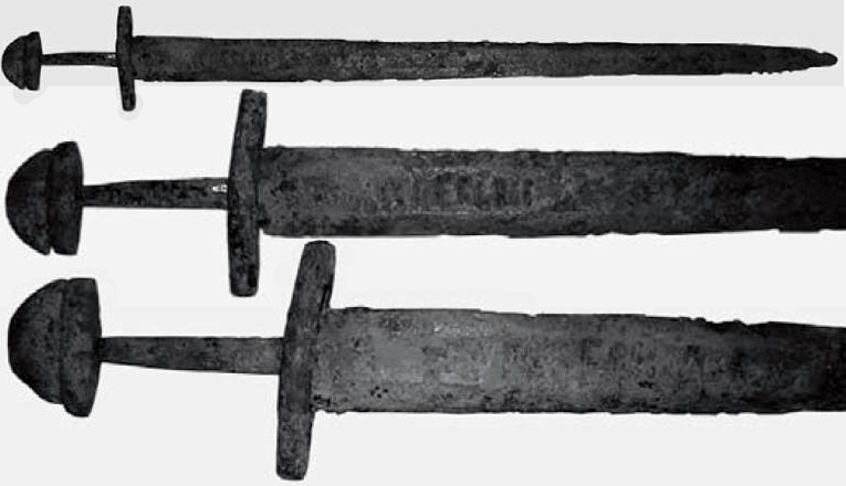

yeah.. Hot mustard. For some reason I kept wanted to eat hot dogs with this technique. Just needed some pickle relish. Ah.... Pickle Relish.... I wonder what that would do to a high carbon steel blade. Happy Wink
I know what you mean about ancient fakes. I have often wondered if some of the decoration you see was not an attempt at mimicking pattern welding.
[I have often thought it strange that of all the pattern welded blades I have seen none of them have had reverse twists stacked evenly... The reason I mention this is that, if done right, it would produce this pattern on the blade. XOXOXOXOXO.
No not hugs and kisses... Circles and Xs are very common design elements and it could be done with pattern welding with reverse twists of pilled layers every inch or so and then staking them evenly in two billets. This is one of the reasons that the lower billet of the Arhus Farm find is of interest, because near the forte it appears that the twist is reversed.]
And then there is that Type X blade found in the Nene River near Raven's Willow England which has VLFBERHT inlayed on one side and INGELRII on the other. This "faker" was certainly hedging his bets.

 Attachment: 115.12 KB
VIK.X.EnglandNeneR.Raven'sWillow.+VLFBERHTC+.InlayOnOneSide.withL&F.inverted.&INGEFLRII.InlayOnTheOtherSide.SteelEdgesHardened..Wisbech&FenlandMus. inv.no.1860.5.MSVS.jpg
Image from "A METALLURGICAL STUDY OF SOME VIKING SWORDS," by Alan Williams from GladiusXXIX (2009) Great Reading
