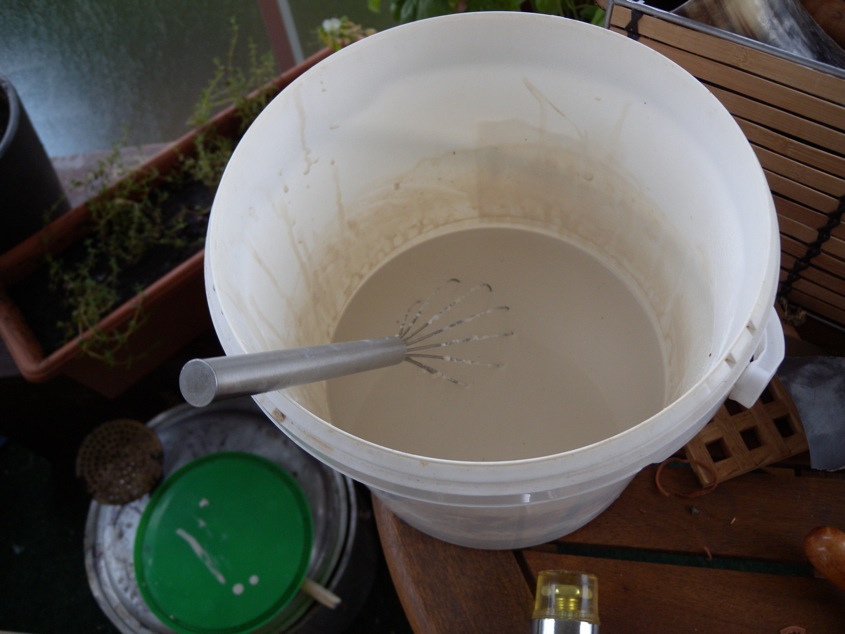

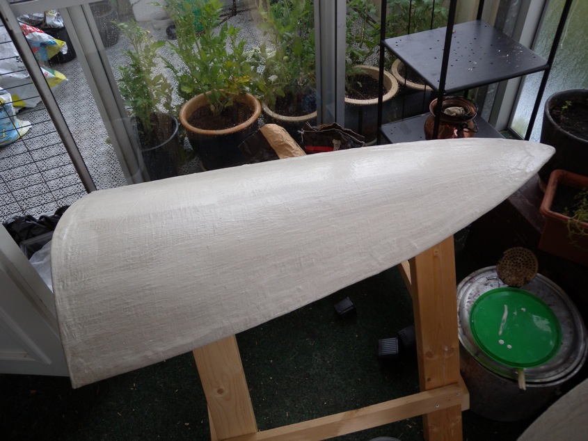

Oh, and not to spam or hi-jack the thread too much..but I have an ongoing heater-shield project where I will make my own paint. I have collected an assortment of earth pigments, lamp-black and chalk and will probably make a glue-paint for the base coats and oil-based paints for the surface layers.
The shields are two layers of 4mm plywood and faced with 2 layers of linen. I have primed them with a gesso primer made out of hide glue and chalk. I have yet to do the actual paint, but so far it looks like my home-brew gesso worked rather well. Time will tell if my other paint will stick to it..
