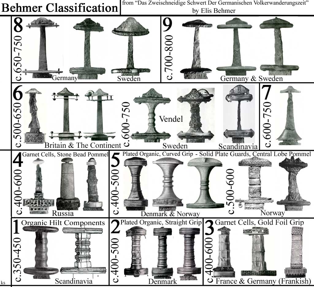

I just cut up a broken sword blade so that I could re-hilt it, I'm planning on doing something from the 8th century, so I was looking at this chart:
http://www.myArmoury.com/talk/download.php?id=35405
and I couldn't figure out what the hilt on the type 8 on the top left corner would have looked like. Was there organic material on either side of the thin metal plates on the upper and lower guard, or were they sandwiched metal as we see in some of the similar hilts? It would seem strange if it were a metal guard, because the rivets are still there, but most of the guards that have organic parts from this period have them sandwiched between two metal plates.

This type swords have mostly one iron plate between two organic plates.Sometime covered with thin iron or bronze plates on upper and lower sides and riveted together.Central plates are mostly inlayed with simply patterns in silver or brass.See W.Menghin,Schwert im fruhen Mittelalter.

Late 7th/8th century (which is when the Behmer type 8s in question come in) is well outside of the "Migration Period" range (the 1st phase at least, which is the bit which mostly affects Western Europe).
Swords of this type often have iron hilt components, sometimes as the middle part of an organic/metal/organic sandwich which, as Robert points out, are often decorated with silver inlay (the inlay decoration of iron items being a common technique in the Merovingian period in Germanic regions), sometimes as casings for organic elements (such as one of the Dover Buckland swords which has wooden guards which are completely enclosed in iron sheet).

Sorry, but that's just wrong. Swords with all organic hilts similar to Behmer Type 1s were being used and buried at least until the 7th century in North West Europe. The vast majority of Anglo Saxon sword burials are of swords which have no surviving hilt elements because they were entirely organic. Some were clearly still in service because some examples (The Crundale and Cumberland for example) were still being decorated in the 6th/7th century, presumably in an attempt to make an old fashioned sword more contemporary.
As for what a sword with an organic/iron/organic hilt might look like, take a look at Hakun's Merovingian swords:-
http://www.hakun-risti.de/Spatha%20Merowingerzeit.html

Thank you Matthew, that sword is exactly what I was looking for. Do you know how wide spread these hilts were? In the chart it says it was from the continent, but they don't seem very common, certainly not in productions.

Hilts of this type fall into Menghin's type F. All of the examples which he discusses are from Germany.
