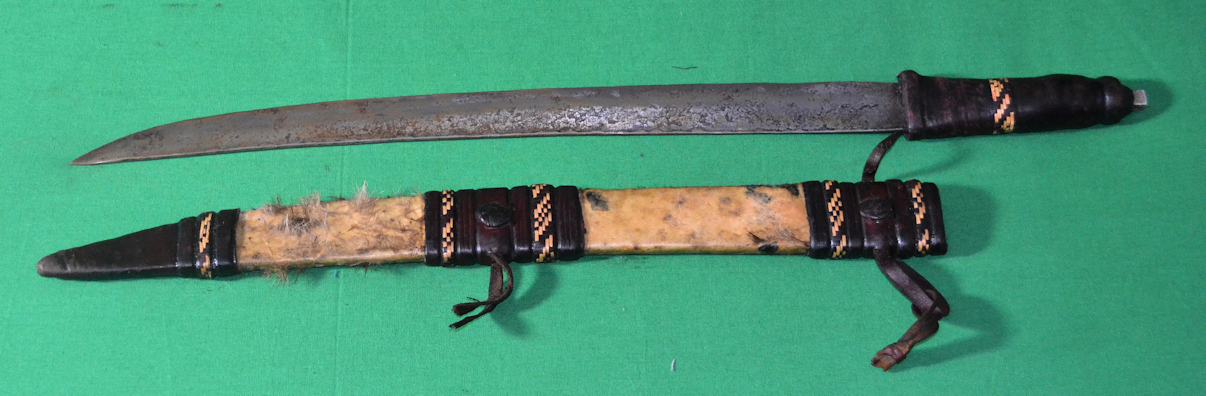

Still researching this one so if anyone has any comments or opinions please let rip. It is only tentatively identified as a West African Manding Short Sword. I am particularly interested to know if he exposed tang is intentional or if it should have a leather pommel cap attached.

The Manding sword, the nub is intentional. Many Manding swords feature a little pommel of brass.

Usually, I see these with some kind of ornament/pommel on the end. From a fairly small rectangular brass piece, various brass knobs, through to what look like wooden balls. I've seen at least one other photo of one with an exposed tang like this, but they seem to be in a minority.
