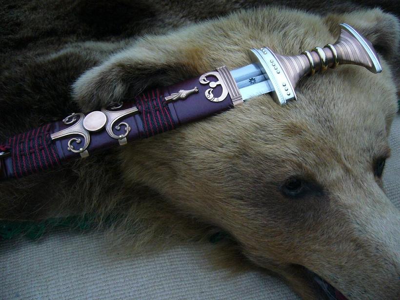

Lubomir Slauka
Location: Slovakia
Joined: 22 Feb 2010
Posts: 8
PostPosted: Wed 24 Feb, 2010 9:55 am    Post subject:         Reply with quote
Hi all
I take part at the forum for the first time and would like to join the discussion.A friend of mine Robert Moc , manufactures swords by traditional technology and from bloom iron.He lives in Slovakia and you can find his products at
www.robert-moc.sk The site is this time only in slovak,but he speak english.
Lubomir Slauka

PostPosted: Fri 26 Feb, 2010 1:21 am    Post subject:         Reply with quote
Luka Borscak wrote:
I can't find any pricelist, do you know what price range is his pattern welded stuff?
I don´t know exactly , but prices of his ULFBERHT and INGELRII was about 1500 € and pattern welded spathas about 3500 - 4500 €
Lubomir Slauka

Andreas Becht
Location: Germany
Joined: 13 Feb 2010
Posts: 102
PostPosted: Fri 26 Feb, 2010 5:45 am    Post subject:         Reply with quote
Wow! His germanic spathas look awesome! That might be exactly what I'm looking for!
