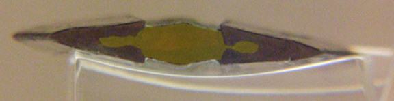

I have done the reading on the sword of King Goujian Lu Cheng of Yue, I now understand how she was made.
I have cast things similar to this in the past. I studied old casting traditions in Japon for the making of bells, the old Shang and Chou processes also. So I am now familiar with how this sword is to be made. Not really that difficult, you loose many before the one that works is acceptable. I believe the tin webbing pattern on the soft bronze core was intentional cast at the same time as was the cutting edges. A interlinking net/spiders web from one cutting edge to the other egde to make for more grip to stabilise the torque from impact. Like lacing your fingers together over a soft item, you can flex the arms and hans without them pulling away from the soft ball under the fingers. The ball takes shock and has compression. Alot is to be expected from just the brief conections between the core and the hard tin/bronze alone!
A hard tin bronze web across the soft core shared by the two edges makes for better structural strength do you not think?
Look at a steel bridge with the cross members from main structure to main structural.
Perhaps I will try one to make in the new year?

There is a little in Yang Hong, but not much. In summary:
Pg 47, 49, Iron-edged axes:
Iron is meteoric iron, about 2mm thick, extends about 1cm into the bronze body. Two axes are shown, both are small. One is about 11cm long, with about 6cm of edge. The other is about 8cm long, edge about 3 cm. How much iron edge has disappeared through corrosion is not known. These are described as too small to serve as symbols of authority or status, too small for practical weapons, so perhaps ritual/religious/cult objects. I disagree that they're too small to use as weapons; even the smaller one could put a 3cm wide and 5cm deep hole in a skull. But they are small. Two larger iron-edged weapons are mentioned that are larger, an axe and a ge. Neither are shown, described, or any details given.
Pg 66, composite bronze jian:
Edges and tip a little over 20% tin, the rest about 15% tin.

"Not strictly pattern-welding, but the Chinese were doing the equivalent in bronze weapons even early, using a combination of different bronze alloys to get hard edges and resilient cores. Also bronze and iron weapons of this nature, such as axes with meteoric iron edges and bronze bodies (some examples in Yang Hong, Weapons in Ancient China). "
The week past I had the great pleasure of looking at one of these composite bronze swords. I was visiting the Royal Ontario Museum in Toronto Canada to view the exhibition "The Warrior Emperor and China's Terracotta Army".
They have one of these swords on exhibit and several of the type with the chrome-bronze alloy that do not show corrosion.
The bi-metal sword is not marked as bi-metal but when I know what to look for it is very obvious. You can have as much time to look at these artefacts as you need, the masses just want to watch the television programmes in the exhibits instead of seeing the original objects!
