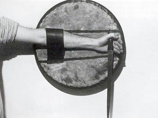

This thread has a pic that illustrates a dirk and targe being held together in the manner described.
However, I seem to remember a thread around here somewhere that states that not all targe grips make this feasible. For instance, in the first pic above, the targe grip would seem to make one's grip on the dirk less than desirable. In the second, your grip on the dirk is better, but the targe might flop or rotate around your arm.
I also think that we shouldn't assume that everyone carried a dirk this way simply because there is a painting with some people doing this.
Edit: Several pages into this thread you'll find a discussion of gripping the dirk and targe together and how that may or may not have worked.
Nathan Robinson wrote: | Regarding of the dirk and targe together, I highly recommend reading "The dirk and targe: their use together" by Colin R. Rolland. it was published in The Third Park Lane Arms Fair Catalog.
Attached is one depiction of how they may have been held together.
It is asked why a person might hold and use the dirk in this fashion. It is suggested that the commonly held belief that the dirk was used offensively is quite erroneous as it is unlikely that any advantage could be made by using the slow and clumsy offensive back-handed slashes that this position would allow. After all, the hand is weighed down by the heft of the targe and the hand's movement is greatly effected by its being strapped into the shield.
Instead two suggestions are presented: the first is that it would provide easy access to the dirk should the wielder's sword become unavailable for any reason. If this were to happen, the dirk would be immediately available without delay. The second suggestion is that, by holding it point downward, a defensive opportunity has presented itself.
Because of the position and size of the targe, the upper body is quite well protected by it, but the lower torso and legs are quite exposed to a cut. The article goes on to suggest that such attacks can be parried by a lateral and downward movement of the targe so as to lock the opponent's weapon between the dirk blade and the targe's edge, "thus unbalancing the adversary and exposing him to a swift courterattack." |
