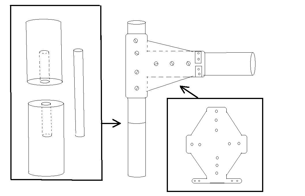

I've made something similar a while back, I'll attach a drawing of it.
The moving part is basically a metal rod and an hole in the middle of the shaft (in my case about 10cm into each part, holds really good). This should work where you want to separate the shaft as well. Maybe use 2 rods if you don't want it to turn.
The L shape joint in this case is pretty much just a T shape where one end is very short. The joint itself is made out of tin, cut out using a shear and a hole punch. In case you have the tools, it could benefit from being made of a somewhat stronger material. I think I'd use a 0.6-1mm thick sheet steel, were I to remake the pole. The metal joint is wrapped around the longer pole, nailed to it, then the excess material (dotted line) shaped with a hammer to conform to the shape of the wood.
All in all it makes for a pretty solid joint, with only a small protrusion upwards. For a more refined look the two flaps on each side of the horizontal pole could be riveted together, maybe a steel rod, similar to the one in the "bearing" could be addedto the core to improve strength.
 Attachment: 46.77 KB

@M. Oroszlany: I never would have thought about making the entire top portion swivel instead of just the cross rod. Great idea. How wide is your pole approximately? And how wide is the steel rod that sits in the swiveling point?

The pole is pretty thick actually, I'd say about 6 or 7 cm in diameter, but it's static (lower end dug into ground), I think this should work pretty well with anything that's at least as thick as a shovel handle. The rod I used is an old drill bit, about as thick as a pencil.
