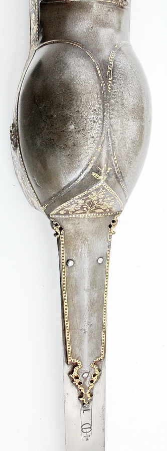

ElJay is correct.
Thai mark was used a lot in the 16th, 17th and early 18th century. The attached is from an Indian gauntlet sword.
The gauntlet is of wootz, and the blade very flexible and pattern welded - so it is an Indian copy. North India 17th to early 18th century.
