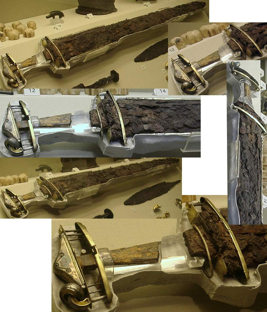

I have also attached some pics of one of the Kent Ringhilt Finds... It is the Dover find in the British Museum. The pictures are by Jeroen Zuiderwijk.
Take care...
ks
 Attachment: 149.35 KB
Perserved in the British Museum
Images by Jeroen Zuiderwijk
