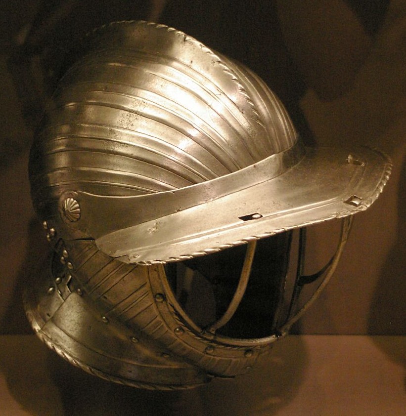

'Maximilian' burgonets are not unusual. I suspect they were mostly used on foot, by captains of infantry, but also by light cavalry. This one is in Philadelphia, I believe.
 Attachment: 157.1 KB

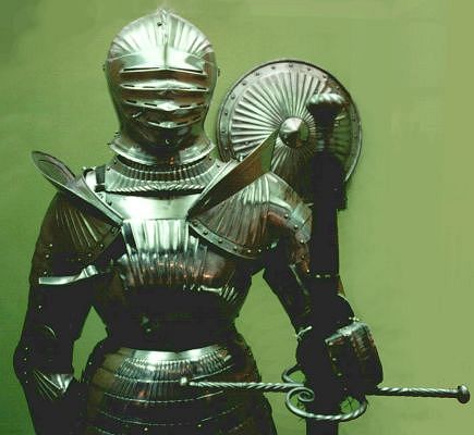

OK...here we go: ""Maximilian" field armor of the "Fico" group, with associated helmet, about 1525-30, with decoration, about 1805. Southern Germany (Nuremberg)"
From the Higgins Armory. This burgonet is interesting. It seems to be an early "close burgonet" with a fully enclosing lower bevor and a pointed upper bevor like the one on an armet. Does the upper half of the bevor pivot upwards? Here's a better picture:
