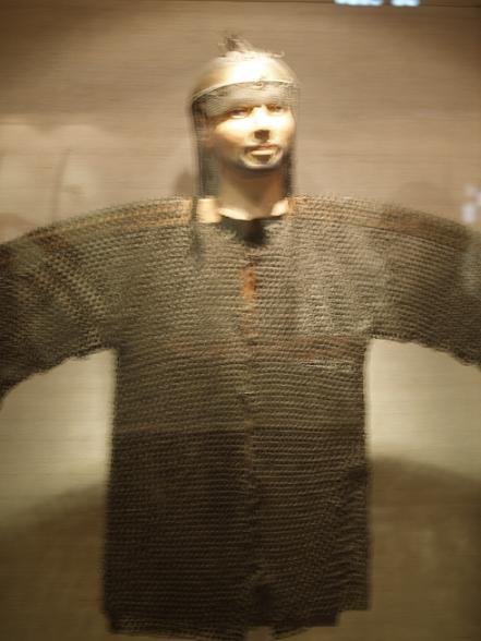

I travelled to India in 2007. At the military museum in New Delhi I snapped a quick photo of a mail shirt worn by an Indian warrior as late as 1700. Indian armies held on to the practice of wearing mail long after military units in the West had abandoned its use. I suspect well-knitted, and riveted mail from India can be found. India is considered a "developing country" within the British Commonwealth, which means prices are lower than those charged in the USA, Canada, UK, or other Western states. And consider this little tidbit--high-end products imported from there will likely be "duty-free" like the gold jewelry, and Kashmir rug I bought while there.
Attachment: 42.86 KB
My photo of the mail described above.
