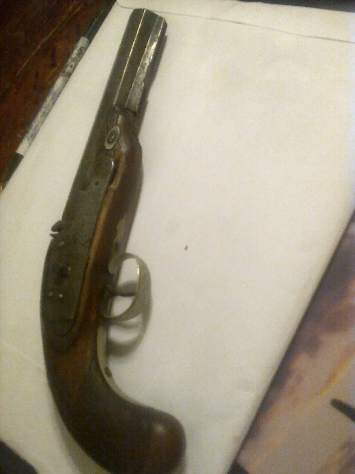

thank you very much i reallly didnt expect an answer so quickly i will be going there this week end and i will get some pics of it like i said it is in sad shape and i just talked to my dad and he said he has had it since 1957 and he had to soak it in deisle fuel for a couple of weeks then to get the barrel off of it. i am just curious to see if it is old or not the only other old gun i have is a 1901 sears and robuck shot gun i think it would be so cool to have something made in the 1800s anyways thank you for your help
i dont know how to add more than one pic on here so there will be more than on comment on here sorry

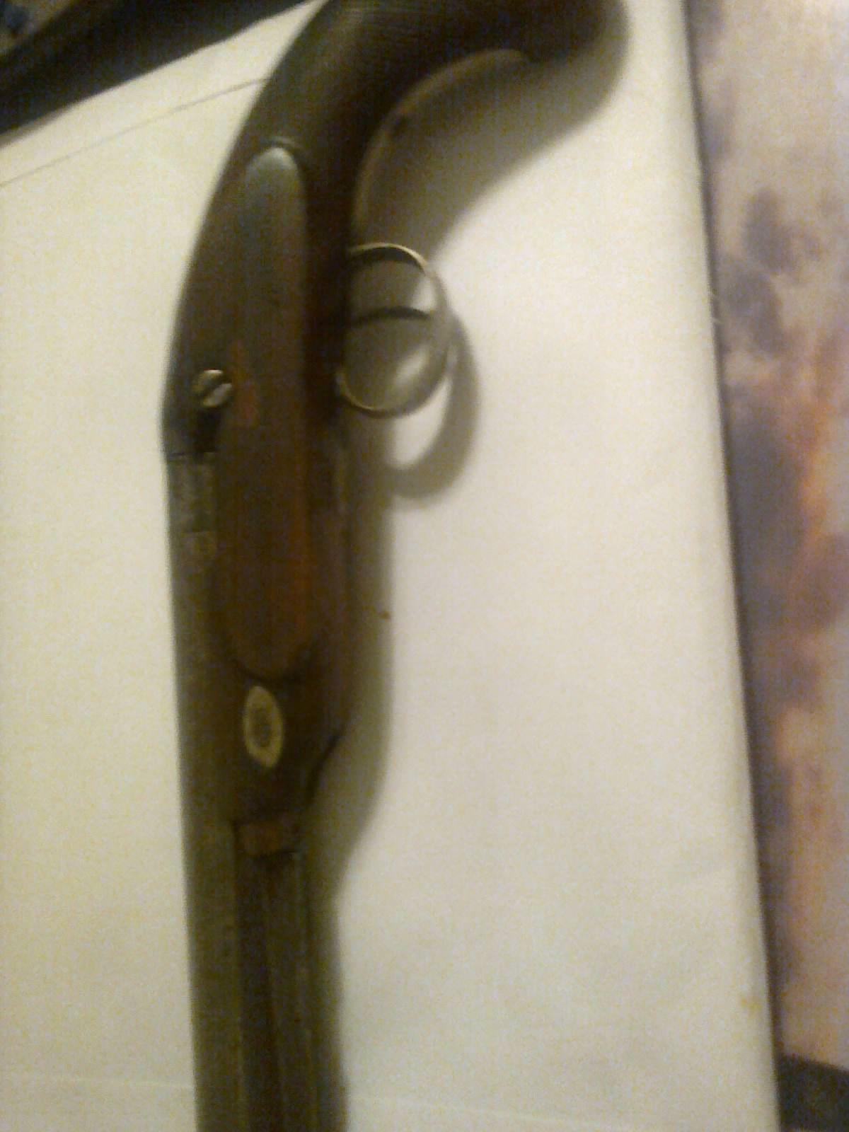

ok here are the pics he also found some numbrs on it the first has a star 58 star 372F the second is A0 and 7 6 but the six is attached to the bottom of the seven then k7 and he cant really read the last 2 numbers he thinks it is 11 i hope this will help in finding out what exactly this is like i said i will be there this weekend and take better pics of it thank you so much

OK...
That helps but not very much. We need clearer photos so if you can get some please post them.
I think you have a civilian pistol, probably a converted flintlock. The lock plate appears to be too large for a pistol, notice how it almost meets the escutcheon for the barrel key. (Now that I look at the obverse side of the pistol, the molding there is about the same size as it is on the lock side. That is still a large lock for a pistol) It may be a replacement. There was a nose cap on the pistol at one point. The trigger guard finial and the half stock make me think this is possibly an English gun dating from the early 19th century. The nose cap is missing and was probably brass or perhaps poured pewter. The markings you describe are not familiar.
With better photos I might be able to tell you more. Keep in mind that there were hundreds, perhaps thousands of gun makers in the early 19th c. not all of whom are documented anywhere. We may never know who made it.
(I have added a photo of a replica KY pistol that looks a little like yours. Note the size of the lock compared to the overall size of the pistol).
