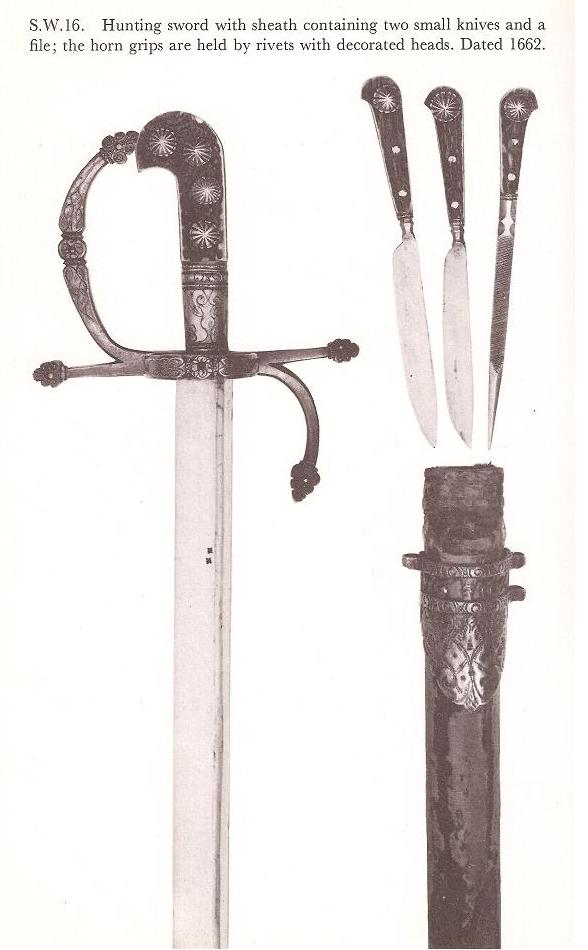

Your link has all kinds of great info in it. Attached is a sword with a similar grip to those shown in the link. It's a different type than the sword in this topic, but the grip is of the same style. It belongs to the collection of E.B. Erickson.
These are some of my favorite "hunting swords" and one of the reasons that I like so much the sword shown in this topic.
 Attachment: 81.96 KB
An antique sword from EB Erickson's collection, German, circa 1660

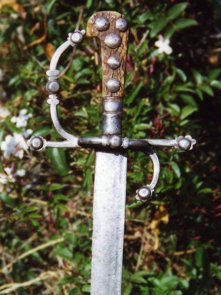

Here is another one from Frederick Wilkinson's Antique Arms & Armor.
 Attachment: 53.29 KB
I love that particular sword. It's been something I've wanted to have made recreated for some time. It's that same sword, actually, that got me so attracted to the sword in question that I posted! I know the only similarity is the grip style, but it's such a unique characteristic.

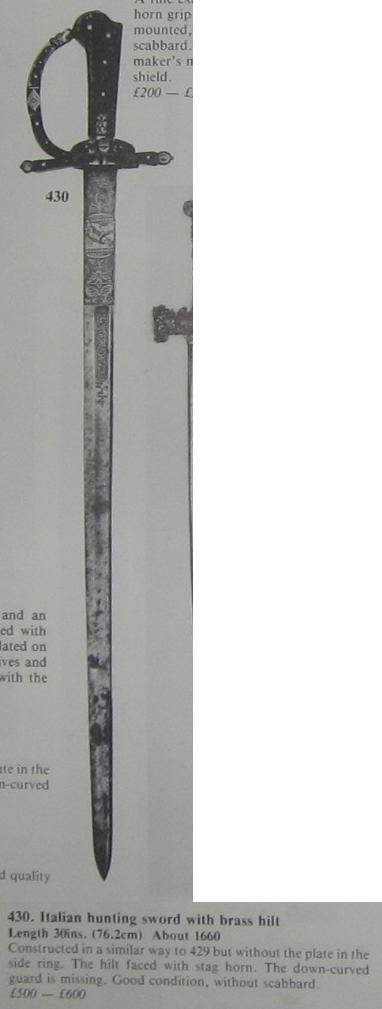

Jonathan Hopkins
PostPosted: Sat 24 Jul, 2010 6:53 pm    Post subject:         Reply with quote
Here is yet another, also from Southwick, but listed as Italian:
(There are several similar examples in the albums here, too, but I am sure you already know that! Happy )
 Attachment: 26.92 KB

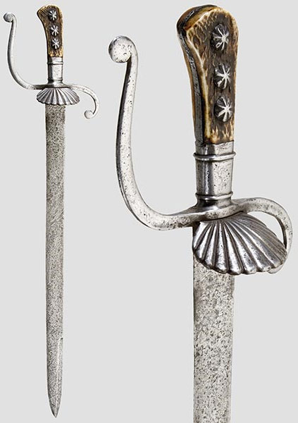

PostPosted: Sat 24 Jul, 2010 7:30 pm    Post subject:         Reply with quote

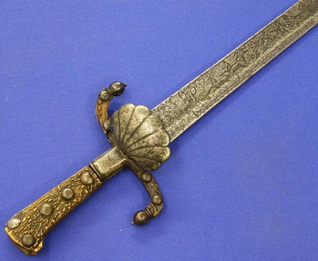

Jonathan found this at Hermann Historica and it even has a clamshell guard!
A German hunting sword
2nd half of the 17th century
A straight, single-edged blade, double-edged at the point. The obverse side has a double groove, the reverse side has remnants of an orb inlaid in brass. Iron knucklebow hilt, sparingly cut, with a shell-shaped guard plate and stag horn grip scales. Iron parts with patina. The decorative rivets on the reverse side of the grip are missing. Length 79 cm.
 Attachment: 112.17 KB
German Hunting Sword, 2nd Half of 17th Century
Copyright © Hermann Historica

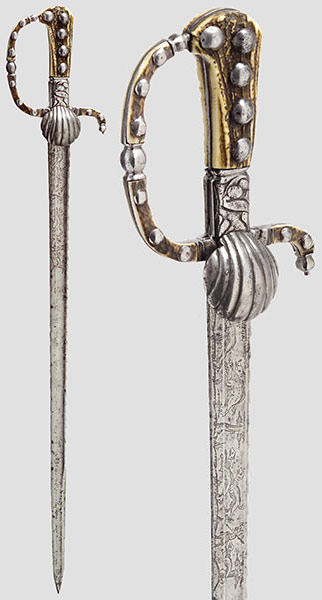

PostPosted: Sat 24 Jul, 2010 7:39 pm    Post subject:         Reply with quote
Here's more from Hermann Historica!
I guess the combination of the parts is not as unusual as I had thought!
First one:
A German hunting sword,
middle of the 17th century. A heavy single-edged blade with a double-edged point. Curved, S-shaped quillons with flat finials. Shell-shaped guard plate. Grip with staghorn grip scales and three decorative iron rivets on both sides. Length 74.5 cm.
Second one:
A hunting sword
17th century
Fullered single-edged blade with a double edged point, slightly spotted. The back of the blade saw-toothed. On each side in the upper third of the blade etched hunting scenes. Simple iron knucklebow hilt with clam shell and stag horn plates, partially subsequently replaced. Florally cut grip ferrule. Grip panels of stag horn with large, hemispherical rivets, one later replaced. Length 84 cm.
 Attachment: 42.44 KB
 Attachment: 34.51 KB

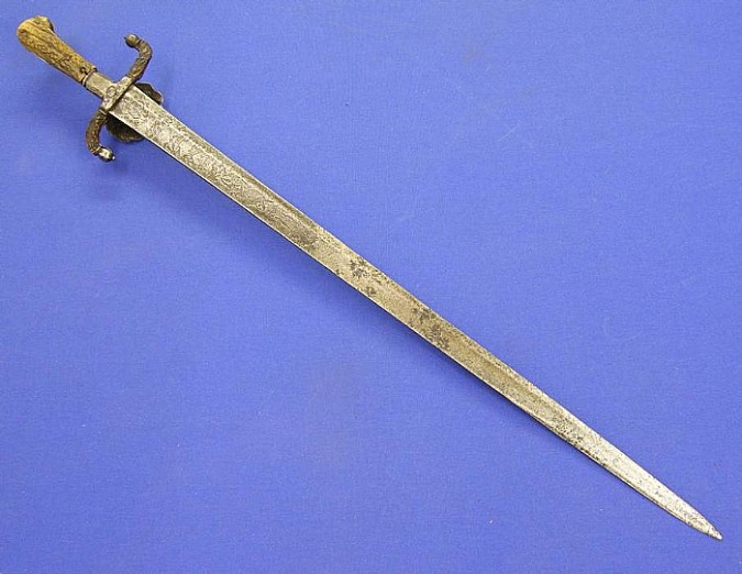

PostPosted: Sun 13 Mar, 2011 7:10 pm    Post subject:         Reply with quote

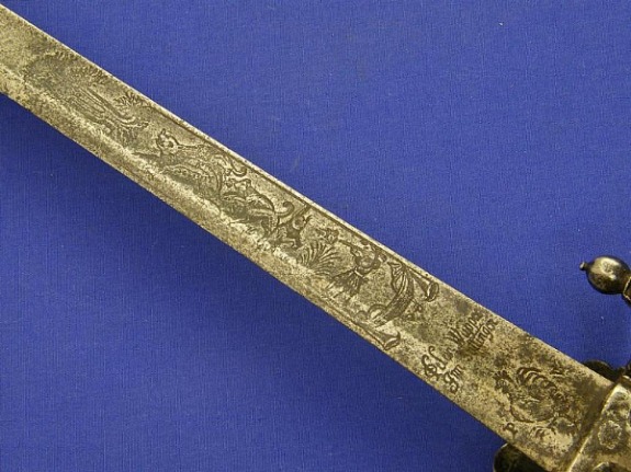

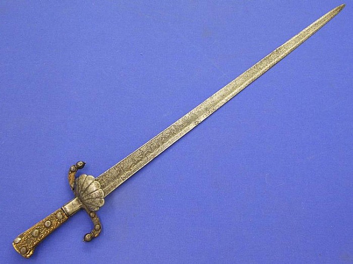

I ran across this hunting sword over at Bolk Antiques, and remembered this thread.
!7th century German hunting sword, 85cm overall length, enscribed with "Peter Wupper in Sollingen".
More photos over at Bolk, at least until it is sold.
 Attachment: 99.52 KB
 Attachment: 92.19 KB

PostPosted: Sun 13 Mar, 2011 8:40 pm    Post subject:         Reply with quote
Roger, thank you for posting that sword. It's quite a bit nicer than the one I own and so it's nice to see it here. I had not heard of Bolk-Antiques before and so have added the site to our Links Page. There's quite a lot of nice things to be found there.
