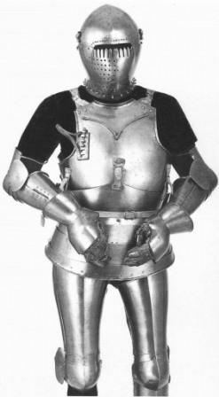

that is more like a 1460s-80s placart is it not? the only ones from early 15thc was low to the belly. ug i'm at work and can't remember the suit it was on.
I have to agree with Chuck. As far as I know, by that time most popular body defence was coat of plates, corazzina or one-piece breastplate. And if you will be going to demonstration I would suggest to wear something more protective than just plackart. Though it will be just demonstration, but it might get quite ruogh because there will be a lot of russians so it would something like a light bughurt. Anyway, see you in Grunwald!!!
Chuck ! You can be my savior ! Where did you saw early plackart ? Please try to renember and maybe you can find some proves of it.

Sorry Daniel - you are very unlikely to ever eat or drink again until you let go of this fantasy. Plackarts are part of a mid to late 15thC item replacing the weaker fauld on late 14thC torso armours. The Churburg S18 harness is a good example of this transition to more integrated breast and fauld that later split into breast, plackart and tassets. I think this is the suit Chuck was looking for.

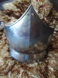

Attachment: 15.2 KB
perhaps 1420-1430?

perhaps 1420-1430?
