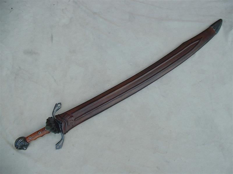

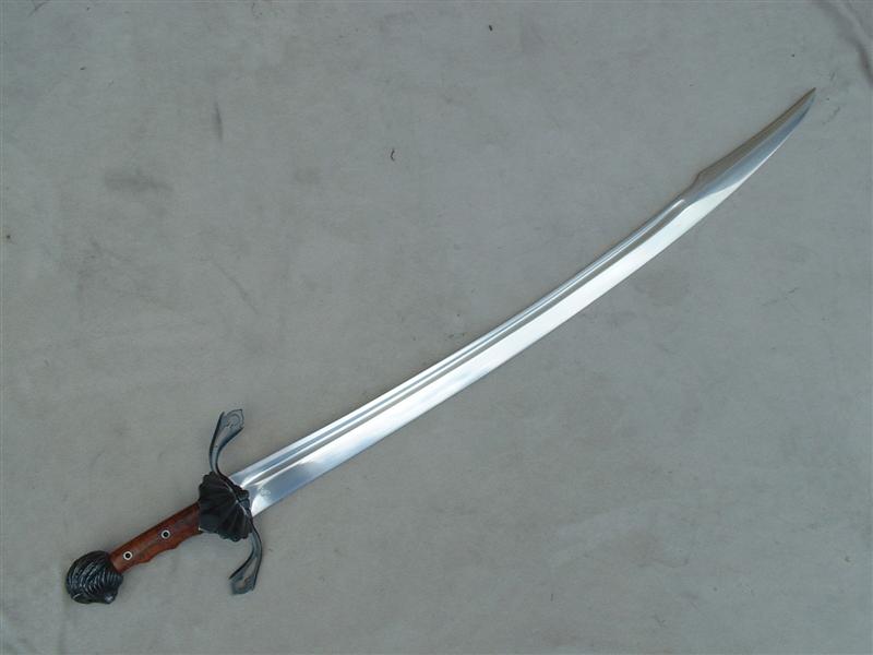

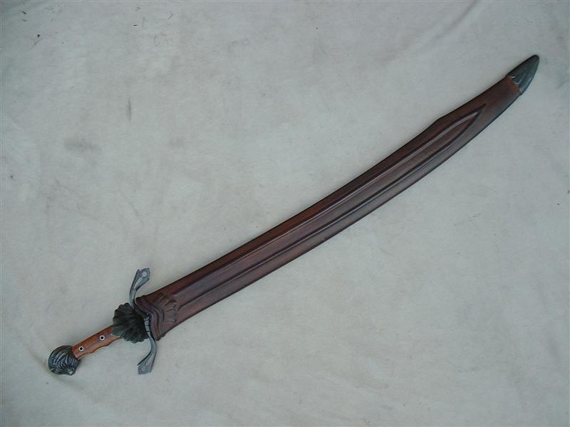

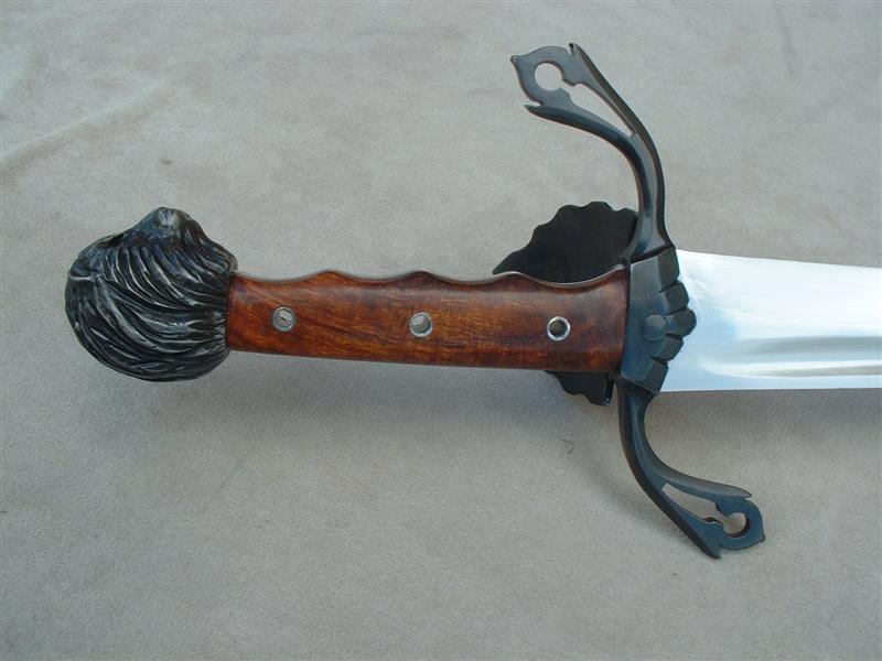

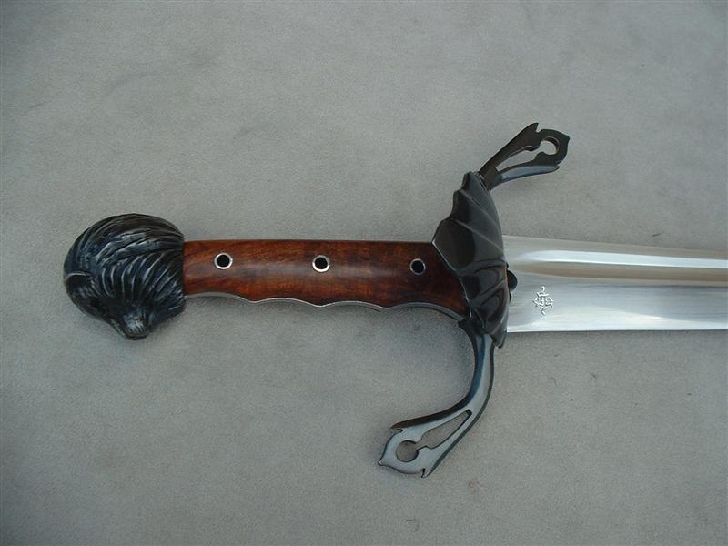

HI, here is a new saber to check out. The blade is marquenched and tempered 5160-H steel and the false edge is sharpened. The side shell is keyed on and peened on other side like a Messer. The slabs are desert ironwood the pommel is keyed and peened. it is a fun sword but not fun to carve:) Thanks!

I love the final look . I presume the bear is a special order by the new owner . I wonder what it would look like with a standard disk pommel, with just enough surface for some engraving or etching, and then of course I wonder what the price would be...Xmas will come again, and I'm trying to be a damned good boy...whoops! another quarter in the swear jar, soon I'll have enough for another project....

Thanks , no it was for a customer. Oh that's supposed to be a lion not a bear :)
Lion
Of course it's a lion! Been watching to many reports about the economy, bear market, bull market.... you end up losing the feeling for the feline.

Cool saber, but... ha ha - Zardoz? Worst movie ever. Ever! Unless you like Sean Connery in red nappies, go go boots and bandoliers. I guess the pommel does look something like the floating head, though. :eek:
The grip isn't really to my taste, but the guard is really nice and I do love sabers with serious pommels. Over-all, that's a really nice sword.
