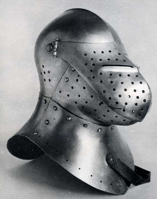

I was wondering if there was a technical name for this type of helmet; is it a Great Bascinet or a tourney Helm or something like that?
Secondly, I was wondering if you fine people could perhaps direct or show me any primary sources or archaeological examples, heck even modern reproductions would be greatly appreciated :D
I'm asking as I'm looking to making/getting one made for a mixture of SCA combats and perhaps Live Steel pomp ;)
Y'know, the whole fancy look with frills and such.
So yeah, any examples or info or help would be greatly appreciated.

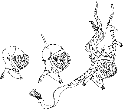

mid-15th Century, from 'Riddarlek Och Tornerspel: Tournaments and the Dream of Chivalry.' p.75.
 Attachment: 5.76 KB

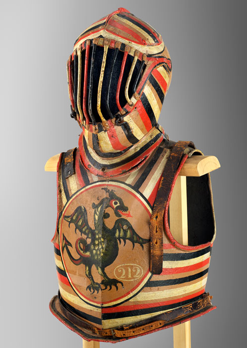

I think these helmets were used for combat with wooden clubs. Hold on, while I find a picture of one. I know there's one in the Met.
In Pisa, Italy, they still have an annual festival called the Gioco del Ponte, which includes a foot combat with wooden clubs, and they still use those same type of helmets (not exactly the same as the ones you've shown, but similar.)
Fantastic gallery of more photos here.
The drawing of the helmet is a black and white copy of this drawing from Rene of Anjou's Tournament Book ("Le Livre des tournois" aka "Traictié de la forme et devis d'ung tournoy") which was written about 1460.
The original is a lavishly illustrated work which has been of great use to historians due to the detail in which it records the clothing and armour.
This is the original image of the helmet
The weapons used in the Tournament described were wooden clubs and a special form of blunt sword
http://www.princeton.edu/~ezb/rene/renehome.html has an English translation of the text as well as instructions on how to access the artwork with the Bibliotheque Nationale website
I'd call the helmet shown in Rene d'Anjou's work a great bascinet which has been given a specialised visor for use in tournament.

 Attachment: 86.73 KB
Another query if I may again...
How would one get into this sort of helm, as it seems that the neck is very fitted so simply putting it on is unlikely.
I thought that it might be like a sort of close-helmet/armet sort of system where you lift up the front visor, then the front part of the 'neck', pop it on and lock it down. But this assumes that they are hinged.
I asked a buddy o' mine and he suggested that perhaps they were more similar to a sallet/bevour combo, that is to say that the front piece or whole 'neck' is seperate and each bit is put on accordingly.
Any ideas or examples you mob?
 Attachment: 57.18 KB
This is an example of the sort of 'neck' I mean.
i believe the whole front can go up so lift the neck guard,insert head, close neck guard.
